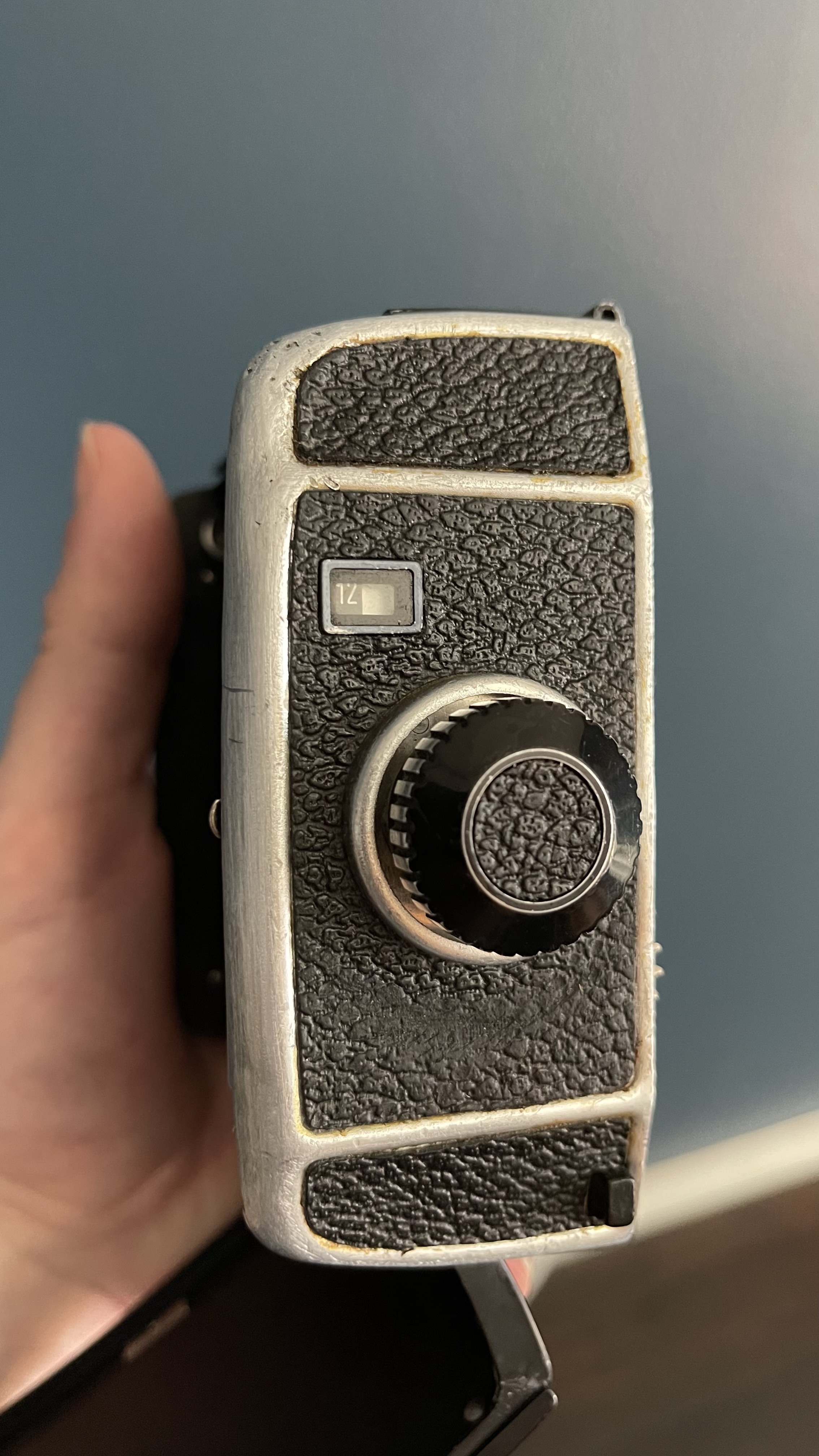

Hi. I recently purchased a Rolleiflex SL66 and have shot maybe 4-6 rolls of film with it. When attempting to load the most recent magazine, I was frustrated when the magazine wouldn’t reset to 1. Instead, the film number display remained set at blank (zero) and the film didn’t “catch”, so I just spooled through the entire roll.
How do I get the magazine to reset to 1? I suspect there’s a mechanism that’s not catching somewhere, but I can’t seem to trigger it.

Okay, I think I figured it out.
1. Remove the magazine from the camera
2. Remove the film from the magazine
3. Remove the thin metal exposure guard
4. Manually turn the little gear on the back of the magazine (the side that would be pressed up against the camera) in the lower left corner. On my camera, there’s a little “hand” illustration that’s immediately below this gear.
5. You may also need to give the magazine film knob a few turns, too. this is the big knob on the left size of the magazine you would usually use to wind the film when loading.
6. BAM! That should work.
