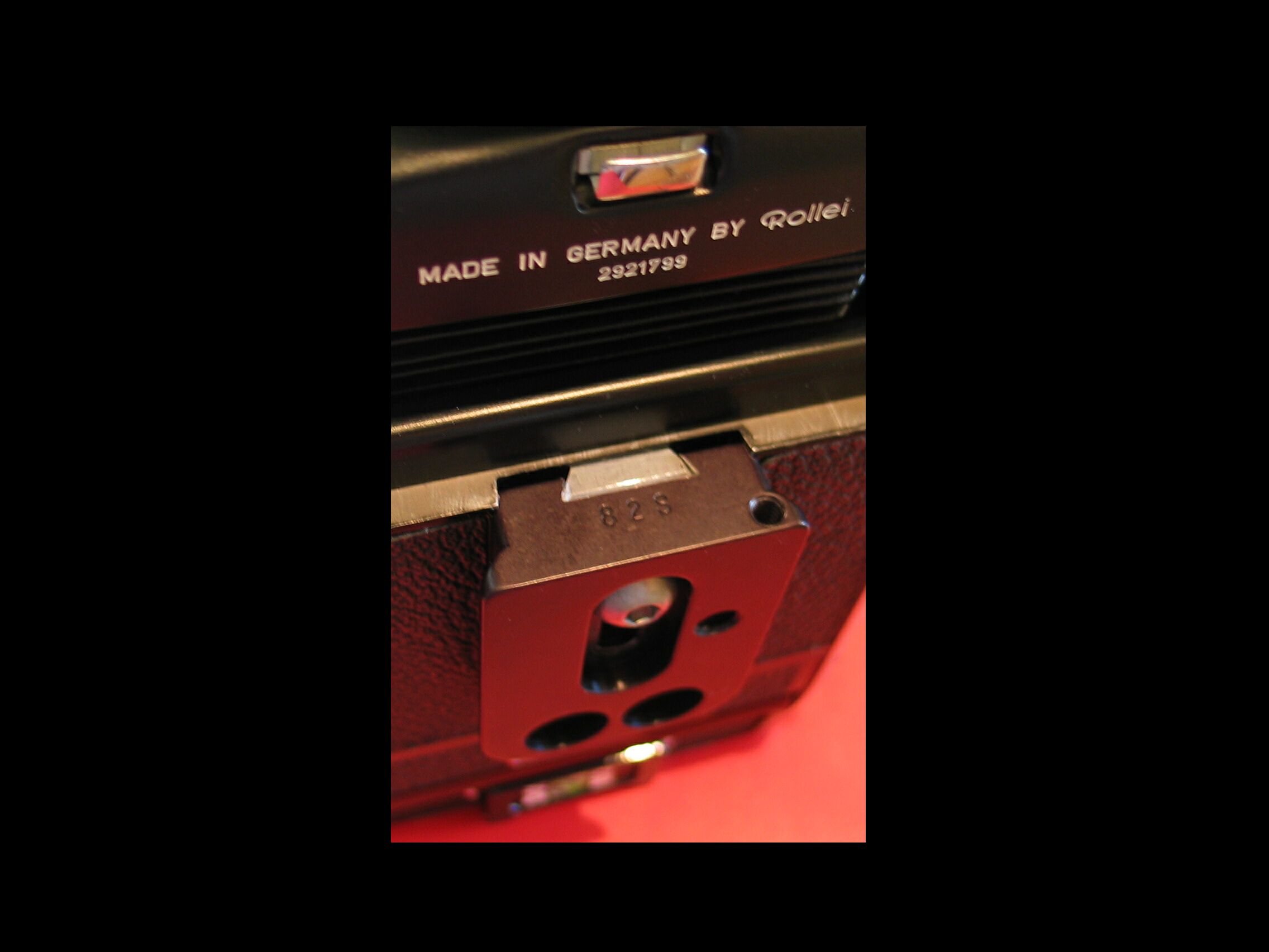

I have noticed a photo of one example where the dovetail is clearly not perfectly aligned, just a proof that it is mounted with one nut with apparent no registration pin. I don't know if they came loose (as some reported) frequently enough to be a concern, I'm not.

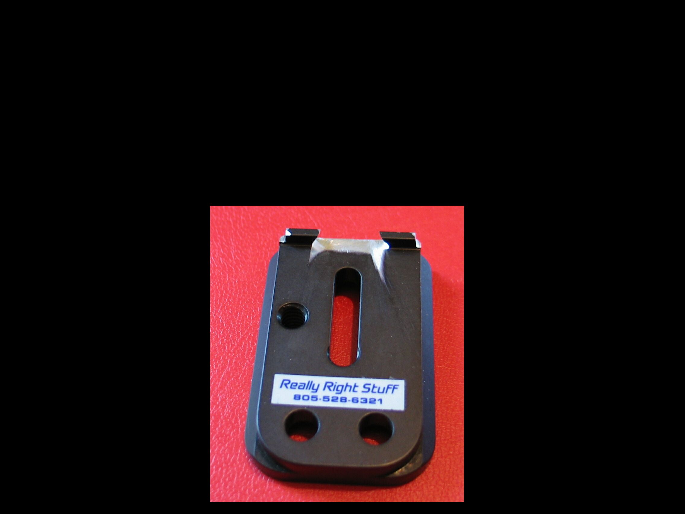

Using Rollei's tripod mount that attached to the wedge at the bottom is not as secure as a plate that covers part of the base. I modified a standard plate which works well. I can post a photo of it in a couple of days if anyone is interested.

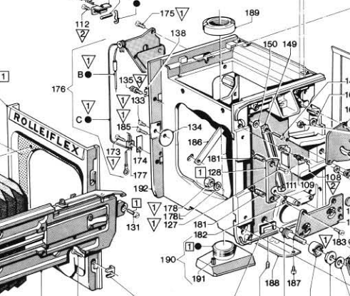

The service manual shows an alignment pin, but over the years, that may have been lost during a service...
The foot (190) is attached to the base by the nut (189) and aligned buy the pin (191).
Thanks, good to know. Mine looks fine and solid, I just noticed in a photo of another example where it was not squared up.
I'm fine with an Arca plate. I am a little surprised by the smallish size of the dovetail given the overall weight of the camera of 2kg . Surprised, but it does not bother me when I use more standard tripod mount.
The dovetail links with the Rollei tripod adapter quite firmly. The problem (with mine) is that the base of the camera seems a bit flimsy (despite its weight!)
Attached my plate. It does not interfere with the lens standard fall. It's a tight fit to the front of the dovetail and where it touches the front of the body, and covers part of the base.
Is this Arca plate made to fit the dovetail then ? Is this still available : I have not looked it up yet, but I simply screw on regular Arca plate which works, but this is interesting.
I filed it to fit, slowly and gradually until it just managed to fit tightly.
oK thanks. I'll stick with regular plate, seems to work fine, even if I needed to choose one that conforms to small unevenness on my body
