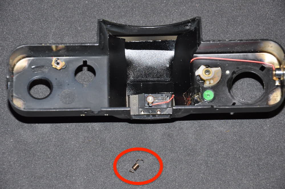

After cleaning the shutter blades, the mirror would not work. Also, there was a very curious 'extra' spring that came out of the camera when I took it apart....
It took a lot of searching, but I eventually discovered where it connects in the mirror mechanism. I have no idea how that spring would have come loose, but it is firmly attached now and that was the main reason the camera did not work. Or at least the mechanical portion of the camera.
