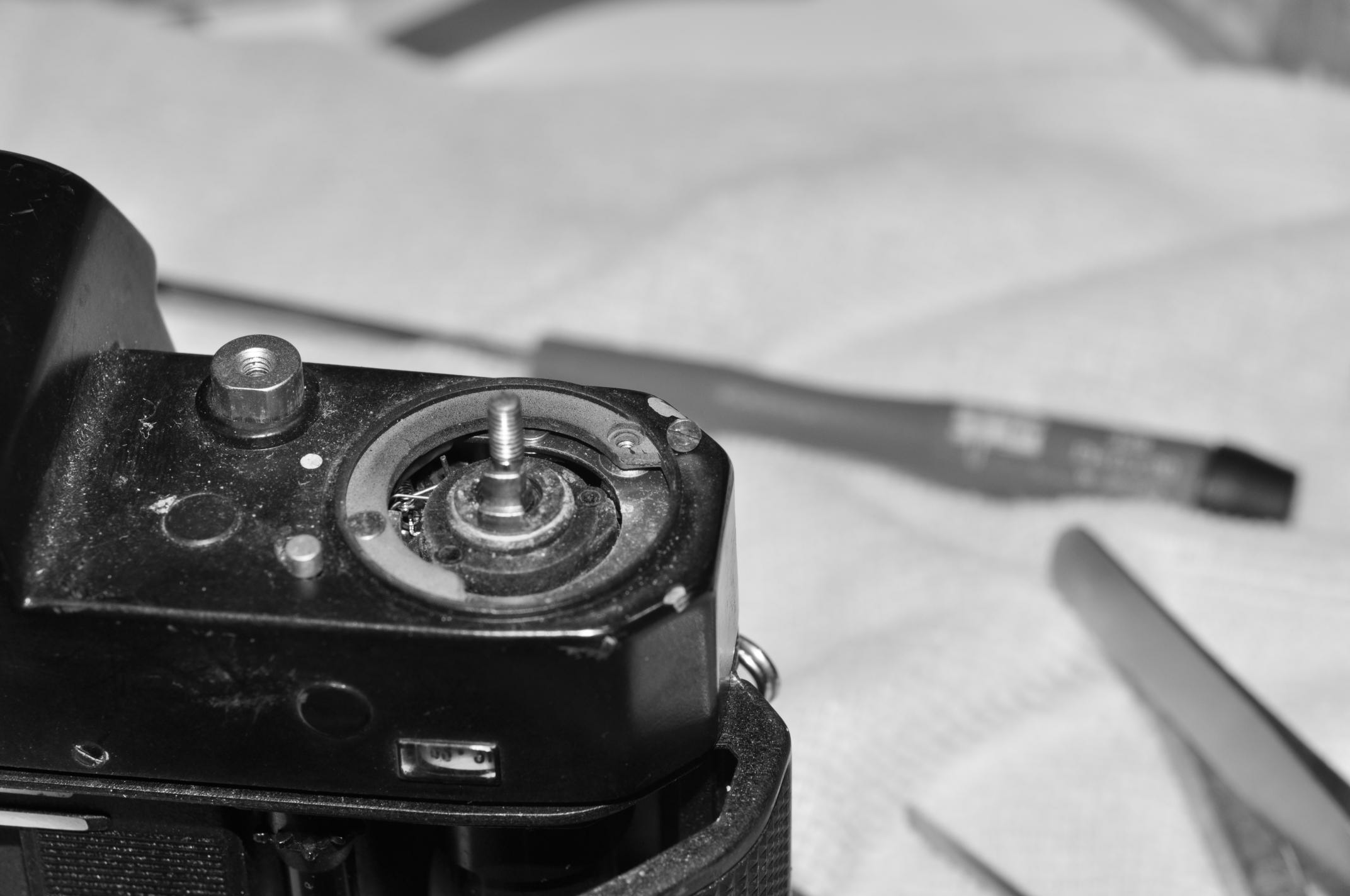

Sorry for another late addition to this thread, but in the past week I decided to take a gamble on a Rolleiflex SL35M. So far it seems to be more or less working, except that the ISO dial is frozen. The manual simply says to turn it, but it does not. Any ideas?
These are the only photographs I have of that mechanism. Lift up and twist to change the settings. Looks like they left out that instruction in the manual.

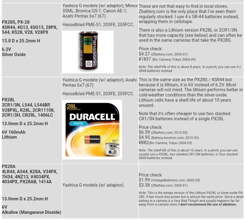

Just would like to update a finding here. Perhaps it is not so important, but I believe a good quality battery plays a key to SL35E.
My SL35E survives from cleaning up the old oil . Then I was asked a few times to repair their SL35E. Some claims are like :
-was ok at first, then the meter gives out a very wrong reading, and later becomes error (all lights on)
-the camera can give correct reading without lens, but faulty once mounted (coupled with aperture pin from lens)
-it gives faulty meter reading randomly.
But all these resolved after changing with a battery. Seriously, a fresh Alkaine 4LR44 could help but won't last long in some cases. In some scenarios, the Battery Check lighted up too.
And these above mentioned events finally happened to me as well. I wondered, and so replaced my own with a better Silver Oxide based battery 4SR44. Everything just back to normal. The Lithium based one like PX28L works well too.
I read the manual again , and inside it has mentioned to use Silver Oxide battery. So I believe this camera is quite sensitive to voltage changes and this is why a silver oxide battery plays a key here.
On the other side I checked those alkaine 4LR44s that causing faults : they all dropped to 5V or much lower already. Those cheap and poor quality one could case problem within a roll or two of films, and the voltage was about 2V inside.
The owner's manual indicates PX28.
Did you see somewhere that 4LR44 is the correct battery? The owner's manual indicates PX28.
Is that PX28 is equivalent to 4LR44? 🤔
Now that you show that, maybe you just had a bad battery. I just checked my cameras and it looks like they also have the same substitution of four LR44 in a PX28 package. So perhaps the 'real' PX28 is long gone.
I did have one SL35E that 'ate' batteries. There was a faint glow of the LED. Turned out to be a short of a wire to the top cover. Maybe other shorts could occur to make the batteries drain when not in use.
I don't think that web information is correct.
AFAIK, the PX28 was never a mercury battery. It was either silver oxide - most frequently used in cameras - or alkaline, which was usually associated with shorter term uses.
