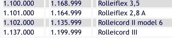

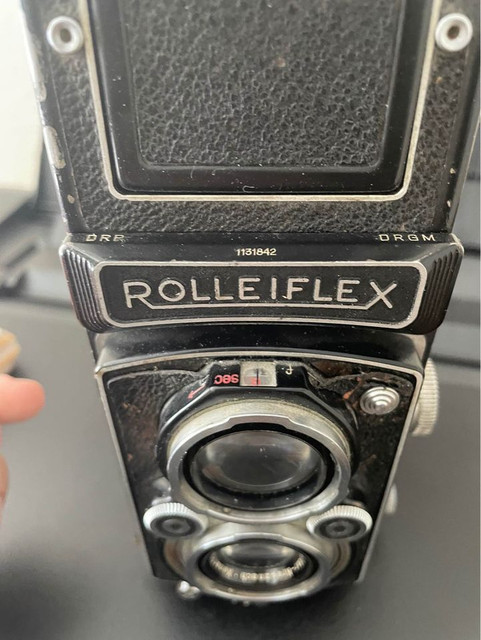

Serial number on this is 1,131,842, which according >>Rolleiclub<< clearly falls within the range of a Rolleicord. But it clearly says "Rolleiflex" on the nameplate.
What am I missing here?
Not sure about that serial number facility… but that’s a RolleiFLEX.

Well, that's what I was thinking too... and was wondering.... are my eyes deceiving me?
Granted, I'm by no means a Rolleiflex expert, and being that they never put any model numbers on their bodies (which they weren't the only ones) makes identifying them all that much more difficult.
Anyway be glad you have a Rollieflex,
Not mine, but am considering purchasing it.
That's weird, according to the "Classic Rolleiflex " book, this number should belong to a 2.8A, and it looks like a 3,5 automat mx...
Ahh... now I see where I got confused. RolleiClub site has overlapping serial number ranges for different models.

I think the giveaway on yours is the shutter and aperture controls being on the front of the camera. To my knowledge, none of the Rolleicords had that.

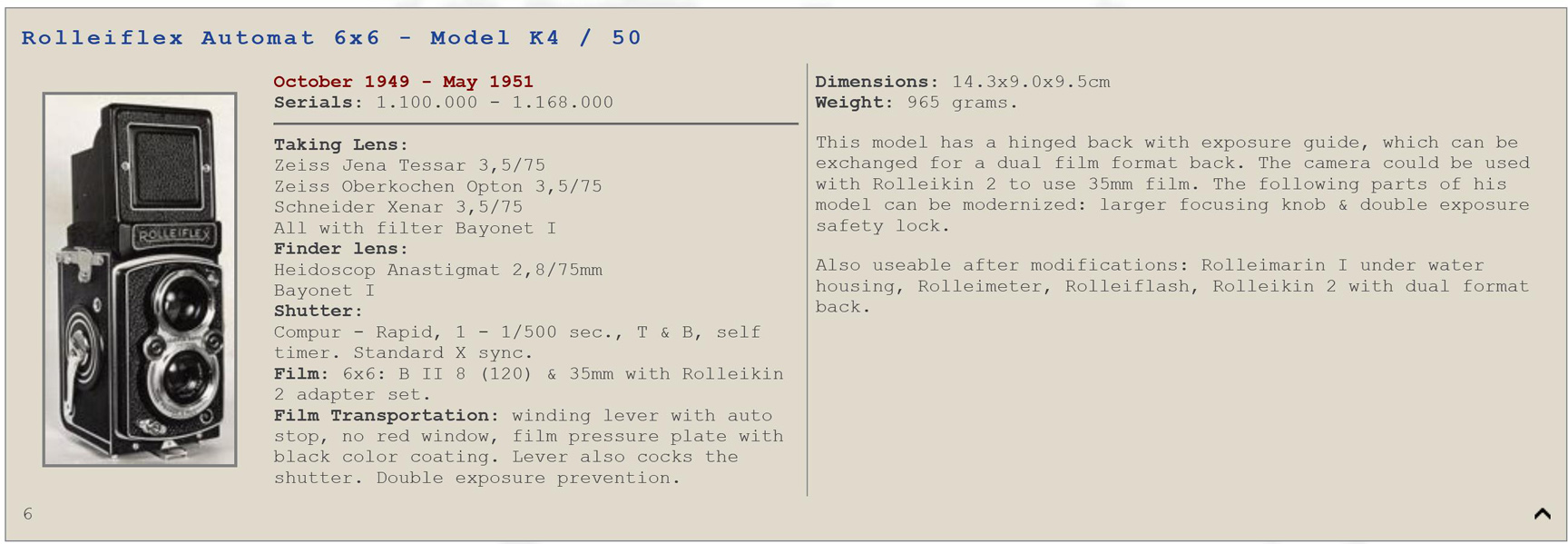

Hi,
just looked in Prochnow's Rollei Report 2...
There is this Rolleiflex model pictured and decripted as:
Rolleiflex 3,5 (K4; Prochnow PR 154/3, Xenar 3.5), made Oktober 1949 to May 1951, 35660 cameras.
From camera 1117000 prepared for Rolleikin,
from camera 1160000 new pressure plate, adjustable for 24x36.
So your camera is in this time range... sure no Rolleicord.
Great camera, btw. :smile:

Yep, it's a 'flex. An early Automat. Looks like a real veteran - from the losing side of a war.

To go back to your Rolleiflex, from the photo you posted, unless it's entirely functional mechanically, don't pay a lot for it...

Yes it's an Automat, a very usable camera, easy to get serviced, a dream to use, but the example from the OP looks very rough. Best avoided and get a cleaner version at least, and get that serviced if it needs it. Mostly the shutter sticks on slow speeds and the winding mechanism can get rough, no problem for a techie, but a clean camera should also come with a clean lenses and mirror. Replace the focus screen for one by Rick Oleson and you have a a great camera.
