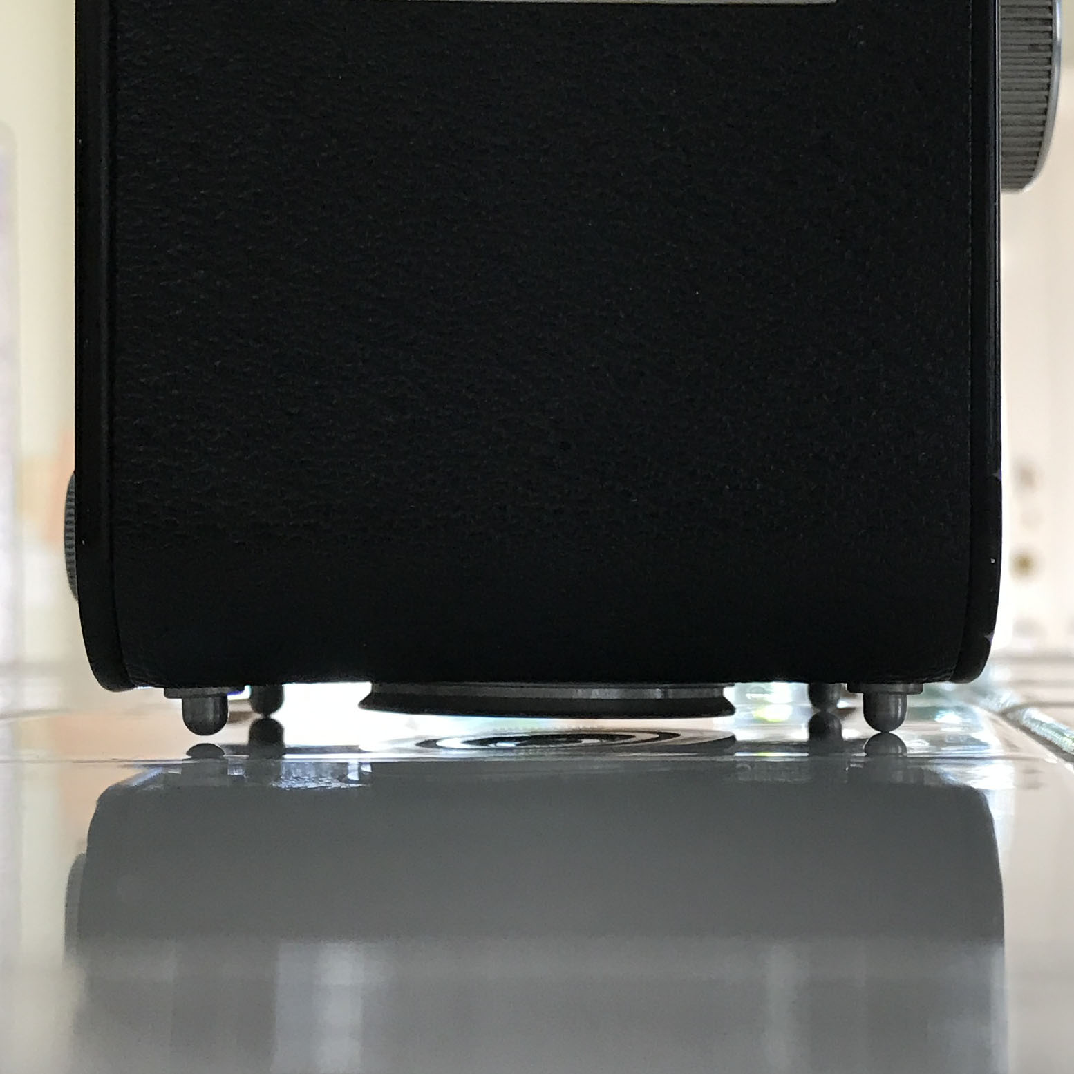

I got a Rolleifix and it doesn't quite fit the Rolleicord Vb I have. It doesn't clear the back posts at the bottom of the camera, and the small posts on the front don't quite line up. Could the body be distorted? The Rolleifix looks to be pretty solid and clean.
Pictures of both camera and Rolleifix, please. Something is wrong. The fit my Vb just fine.
It sounds like your back might be warped? When you sit the camera down on the bottom pins on a flat, hard surface can you rock it any? If it doesn't sit squarely on all four pins, then something is amiss and may be why your Rolleifix doesn't align properly. It might be helpful to post some photos of the camera back and Rolleifix.
All I can tell you for sure, is that the Rolleifix fit my Vb perfectly.

Took some photos, and I can see the base is distorted ever so slightly. I guess I need to find someone to repair it. I've heard Fleenor has a backlog. Has anyone used Steve's Camera Repair in Culver City for Rollei? I don't even know if he works on them and what his workload is.

Looks tweaked... more than I’d call “ever so slightly. :smile:

Peiter12, I second Brian's comment and I'd bet that's why your Rolleifix doesn't fit properly. I'd also bet someone used it on a tripod at some point without a Rolleifix. Or, maybe, they fumbled the camera with the back open.

Hmmm... I think you are right, Alan. This does look like what would happen if, say, you had the Rolleicord on a tripd, bundled up the tripod, and walked along with the camera still attached. The metal disk which has the tripod mount and the door latch anchor would be stable, but the thin aluminum surrounding the metal disk can bend as the weight of the camera leverages against the base. Great example of what the Rolleifix is meant to prevent.
Peiter, if you have any experience with bending metal, it wouldn't be that hard to straighten this out. You have a large metal disk to serve a the leverage point! You could attach a standard quick release plate to the tripod hole and rebend the bottom. This plus a little delicate hammering in appropriate places would gets thing pretty straight. Be sure to check for any creasing or cracks that could cause leaks.
