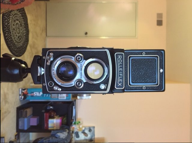

OK folks! Here are some snapshots my Rolleiflex Automat fresh from repairs :smile: Sorry that I don't have any sample photos yet, but the aperture and shutter speed controls seem nice and smooth, and the shutter speed sounds good.
attachment.php
attachment.php
JPD
Mar 24, 2007
2,170
Sweden
That's a beautiful Rolleiflex 3,5 A (also called "MX" in North America). Very pretty indeed! Most have lots of signs of use, so yours is one a collector would love to have, and one many users would dream of owning. :cool:
