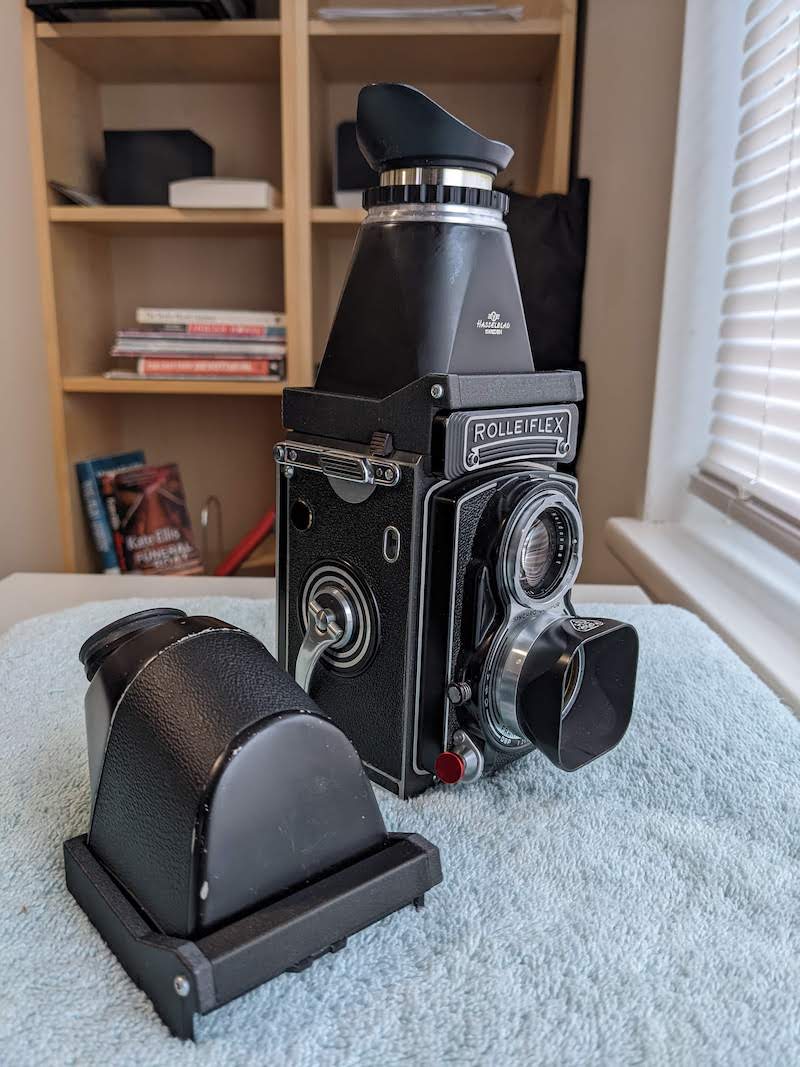

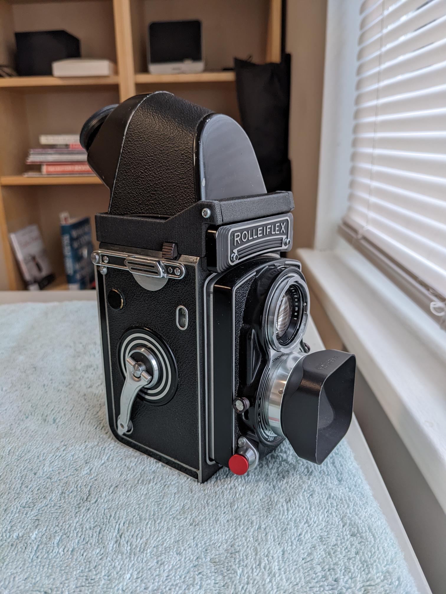

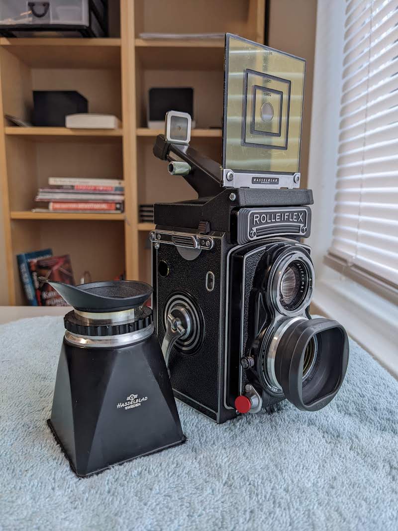

There is the ebay guy, although his version requires removing and replacing the plate on the bottom of the viewfinder to install it on the adapter. Rather than dismantle my finders I printed an adapter in carbon reinforced nylon that is separable to install the viewfinder. It works nicely with a Hasselblad 45 deg.

I think the design is not quite ready for sharing / commercialization. My design currently works only for Hasselblad products. It is incompatible with Soviet 45deg finders due to the different relationship of the prism housing to the base plate. In spite of what a lot of people believe they are not identical, or at least my sample is not. Having sold stuff on the internet before I know that there will be some impossible to satisfy idiots who will expect universal compatibility, including with metered finders. I am currently working on another version that is more universal, that will accomodate metered finders, and be case compatible. That puts some overall volume constraints on the design, and I must be very confident in the adapter to not accidentally release. The current version is very strong, but I don't want to hear about anyone carrying their assembly by the viewfinder and having the camera fall off.

As a retired machinist I could make it out of metal, but also as a retired machinist I don't have a vertical machining center for my use anymore. I don't think there is much reason to use metal for this part. Carbon reinforced nylon, and especially continuous carbon reinforced nylon, can be adequately strong for this part, is much less expensive, and can be used as printed. No painting or anodizing to worry about.
