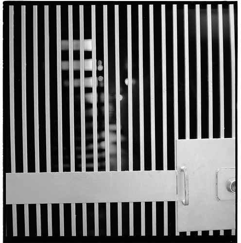

I've seen it in a 75mm Xenar and a 75mm Xenotar. Haven't noticed it in an 80mm Xenotar. Haven't shot enough with a Tessar or Planar to say. Very very slight in all cases. Here's probably the most extreme I've seen, Xenar on a Rolleicord Va(2)-
