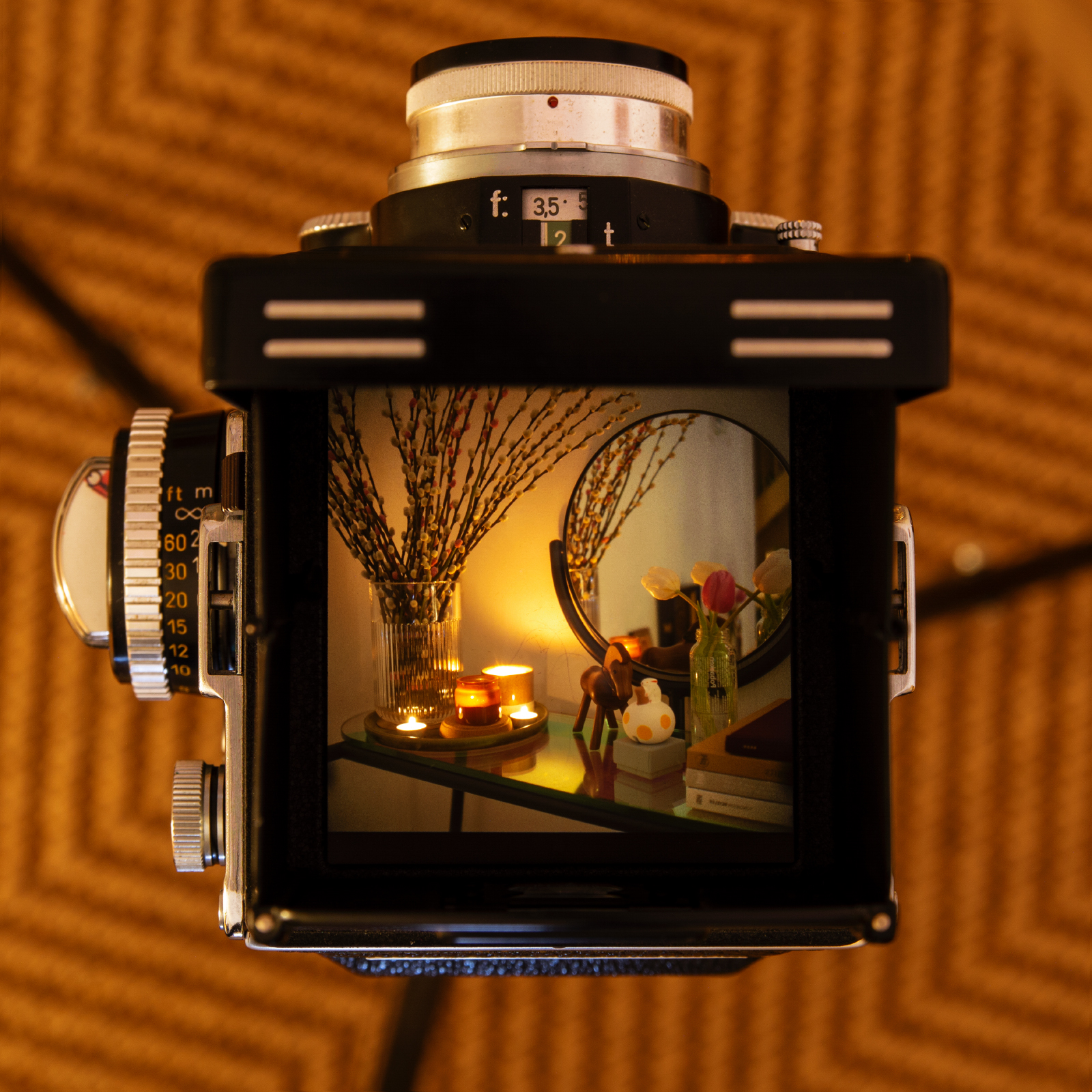

I have a very nice Rolleiflex 3.5f. A year ago I bought a Rick Olsson focussing screen (splitscreen). Now, I'm looking for the most bright screen possible. Will is this the most bright screen out there, or is the Maxwell screen much brighter (from what I read, it has a "pop" effect) and is an upgrade worth it?

I would recommend not over-thinking the focus screen. The original 3.5F screen is plenty good, so is the Oleson screen and Maxwell screen. You don't get that much difference in practical use for critical focusing. Some might be a tad brighter, while some might be a tad more snapping in/out of focus. Enjoy what you have. :smile:

Here's a comparison of different screens. The Rolleicord Split at the bottom is most likely a Rolleiflex F screen; the split was in Fs and Es while no focusing aid was in Rolleicord Vbs (only one that took removable screens). Yes, the Maxwell is brighter by a bit. Best of luck getting one.
