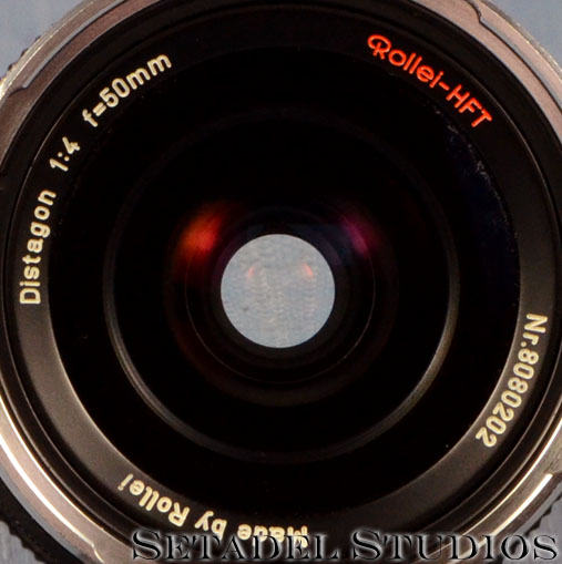

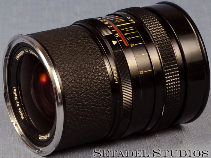

Hello APUG. I have a rolleiflex 50mm f/4 lens on the way. It appears that from the photos of the item that it does not accept standard screw type filters. So i will have to use a adapter. I have a generic bay IV adapter on it's way from china to to use with my existing 67mm UV filters. But i do have a few questions. With the adapter and a filter what lens hood can i use? Will i be able to use the Moose's style circular polarizer with out any vignetting?
Thanks

The filter adapter should fit on the inside bayonet and the lenshood on the outside bayonet. I had that same lens you are getting for many years and only recently upgraded to the PQ lens just to get wide-open metering. The older lens is a great performer.
