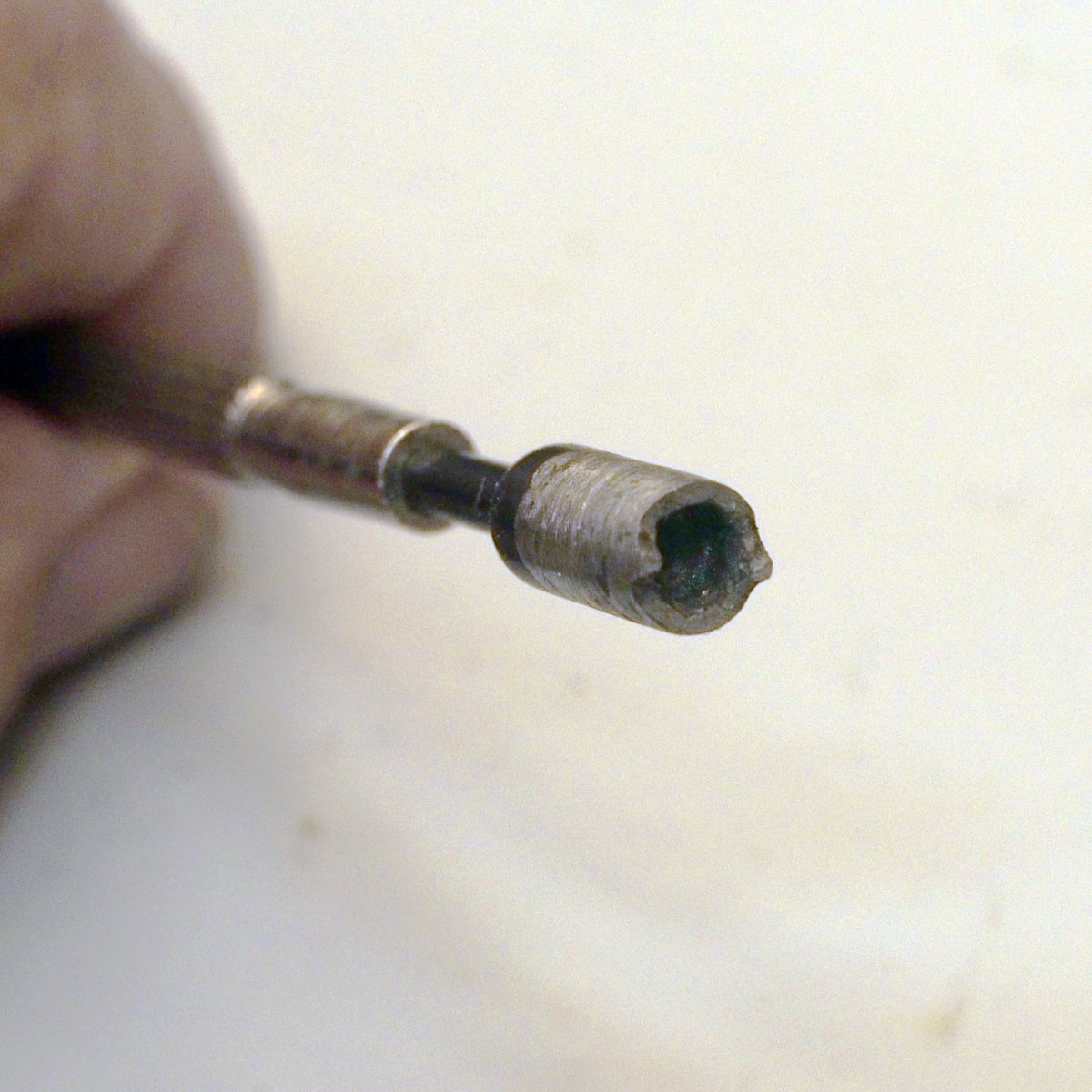

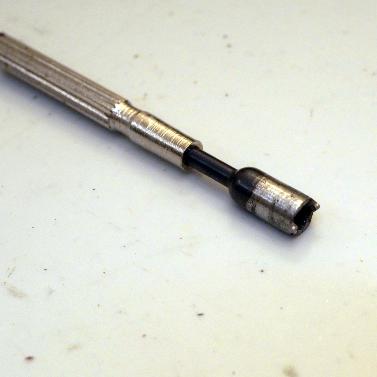

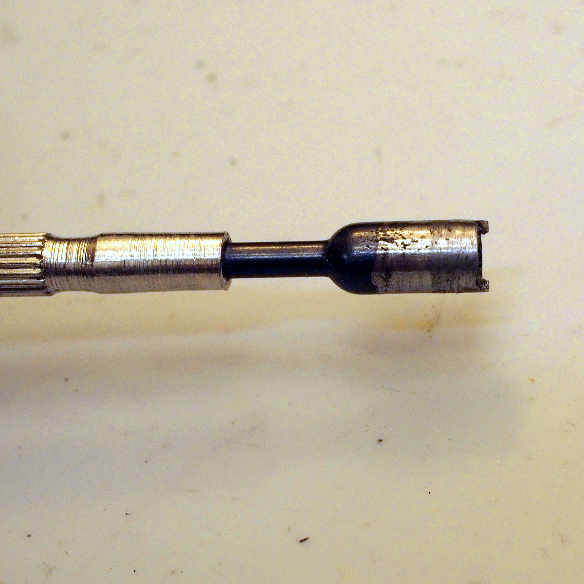

hi from France
Daniel have you an idea of which type a special tool is needed to remove the collar around the flash synchro ? any picture or video ?
many thanks
I took a socket driver that fit around the flash sync post. I ground away the outside of the driver so that it would fit in the recess. Then I ground away to get two prongs.
Actually I made this for the same thing on a Rolleiflex T and later found out that the same setup works on the Baby Rollei.
Great job and great tool Dan. many thanks for the pictures.
