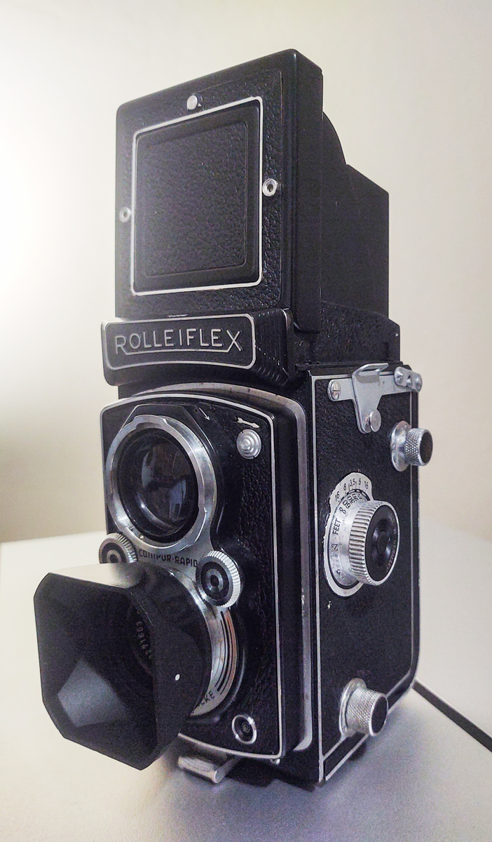

Yes, this is what my camera looks like. I believe it is the Automat K4B2 variant

That's a "K4" (internal factory name) made between October 1949 and May 1951, the first true post-war model. The viewing hood is the correct one for this model, sturdier than the old one, and has a sportsfinder and a better magnifier. If you need a new one, try to find one of the same type. A Rolleicord II or III finder would fit, but that would be a downgrade and make the camera a "Frankenrollei". This example looks so good that making it a Frankenrollei would just be wrong. :smile: What's the problem with the finder?
This camera is often called "Rolleiflex 3.5 X" because of the X-sync.

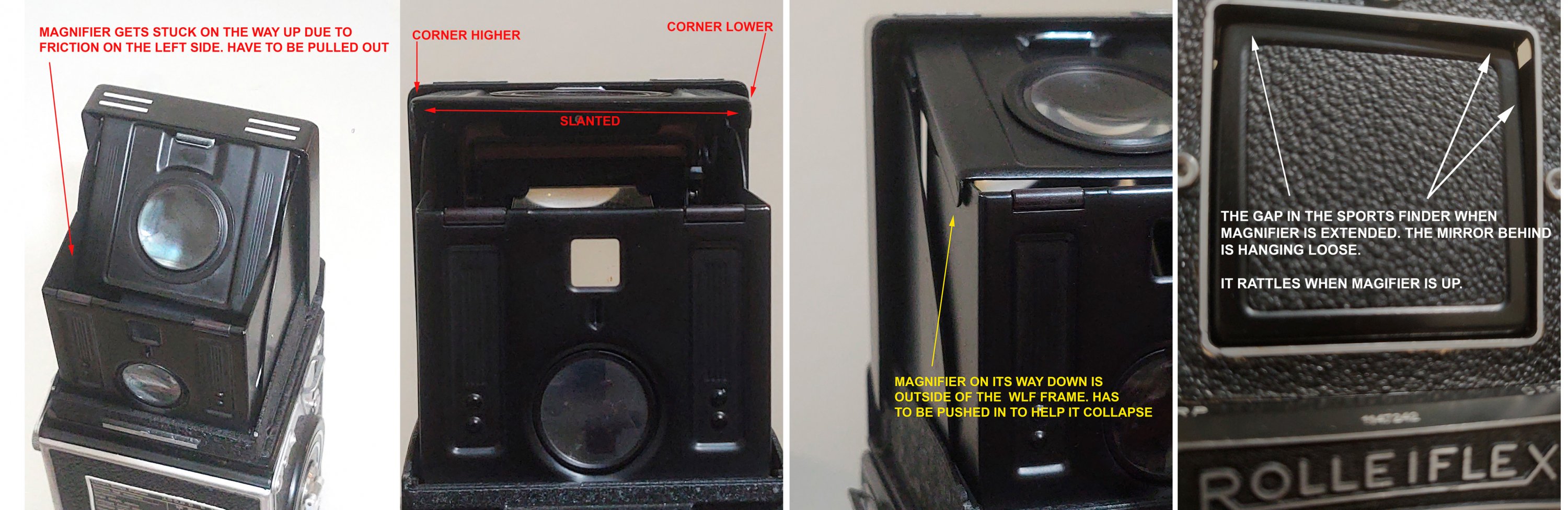

Thanks for responding and thanks for identifying the exact model of this camera. I was thinking it is an Automat K4B2 from seeing a photo that looked similar. Rolleiflex model names and variants are confusing as heck. I don't know what they were thinking. In any case, I do not want to make a Frankenrollei out of my camera. I would rather fix it, or try to find a similar 'for parts' model with an intact WLF.
The problem with the WLF is thus............ In a rush to close the WLF, I hurriedly collapsed the hood without making sure the magnifier was locked in place. It immediately got entangled inside, with the rear wall of the hood vying for space with the magnifier. When I tried to open the hood, it wouldn't, so I tried to pull it and something bent. It was finally freed and it works now, but not as perfectly as before. Some of the sheet metal got bent, and so on the way up, the magnifier sticks because of friction with the left wall. It is very obvious when pushing the magnifier back to close the hood. The magnifier platform is outside of the frame of the hood and has to be gently pushed to the right to get it on track. Also, when the hood is in the open state, the front sports finder window creates a gap and the mirror behind it rattles. The 4 images will explain the situation better.
It works and keeps on taking great photos, but I would rather it be as good as it was before I damaged it. So I am looking for a proper replacement WLF. I don't want to go straightening sheet metal 'cause I might damage it further.

Yes, there are many models of Rollei TLRs, and some collector's books and sites can add to the confusion when they have their own naming schemes. It's worse, though, with the Rolleicords. The best books are the Rollei Report 1 and 2, for the TLRs. They are in German, though.
Good pictures. I wouldn't have dared to try to bend and straightening the sheet metal parts either. I have looked on eBay, but couldn't find a matching WLF, but they do show up there from time to time. Most of the good ones sit on cameras that are also in good shape. Another alternative is to send the camera for repair. Then it's under warranty in case something goes wrong. A plus is that the finder looks good, so having it fixed so that it works as it should would probably be better than buying an ugly spare.

JPD and ic-racer, I hope you both are right that this can be (easily) fixed to its original state. I would rather do that than to append a part from another camera. If anyone has an idea who could do sheet metal work like this, please advise me. Thanks.
Contact Glass Key phoot in San Francisco- https://www.glasskeyphoto.com/
They deal with a lot of older cameras and know a few people who might take on this work. It's really just a question of getting a proper hold, making certain and bending happens in the proper place, and being 'firm but gentle.'
If they can't help, drop me a DM.
Much thanks for the reference, Dan. Let me call them Tuesday. If they can't help, I will DM you.
