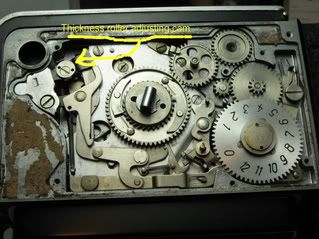

There is a problem with the film start sensing. Should be around 3 or 4 I believe.
The eccentric #8 on the diagram needs to be adjusted. You don't need a feeler gauge if you wasted some film that you normally use.
Here it is from the side:

I am going to try to adjust the rollers which sense the film starting point. What is the clearance between the two rollers supposed to be?
Dan Daniel
Jul 4, 2009
3,056
upstate New York
When I have done this, without the proper tool, I simply moved the cam until I got a roll of film to kick it into action. Make a scratch mark on the adjustment cam, loosen, rotate a bit. Run a test roll. If it doesn't work, try the other direction. If neither work, try a bit more movement on the cam.

I adjusted it to both extremes. It seemed to be tightest when the wide part of the cam was facing toward the actuating lever.

And how are you testing? I've cheated the lever that the back presses when closed with a shim. Then I can simply pull a piece of backing paper/tape/film through the rollers.
The reason I ask is that the couple of times that I needed to adjust this, I found that there was a mi-range area where it worked, but if I went either too far or not far enough, it didn't trip. Don't mean to harp, just something about using tape as a shim on a Rolleiflex is bothersome :smile: then again, with wear I guess a part(s) can go completely beyond tolerances.

When I was adjusting it I used a piece of paper with a double strip of masking tape across it. I turned the cam until the paper + tape tripped the sensor. Then I replaced the cover and successfully loaded a roll of Arista Edu Ultra 400. When I tried a second roll, however, the sensor did not trip. That was when I resorted to the tape on the fixed roller.

One thing that I did notice is that when I close the camera back (or simulate it by pushing on the lever which senses the camera back closing) the film counter resets to zero and the sensor roller comes up to contact the upper roller. You can actually feel it snap into position when you push on that lever.
