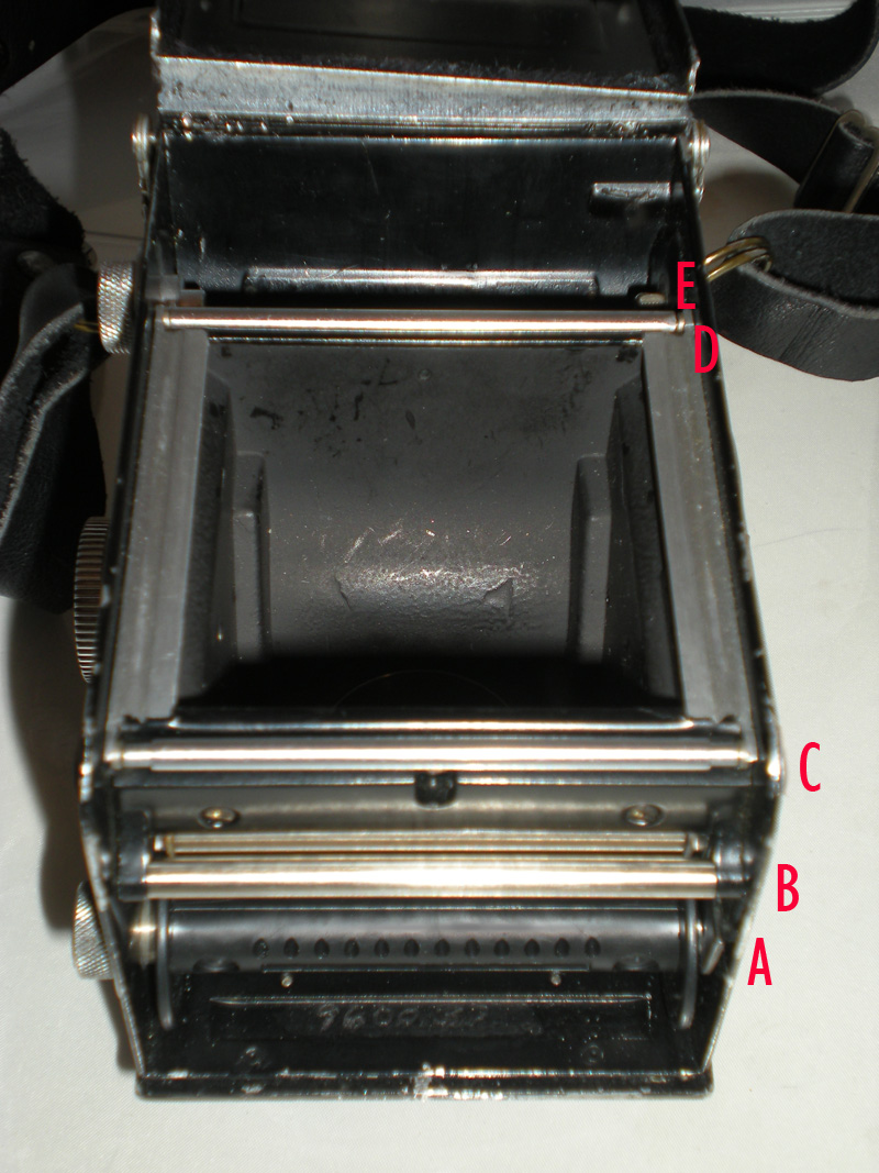

I also have an Automat Model 2 (serial 1030###), and have enclosed a shot of the back below. I also have a Model 4 (serial 1271###), which loads exactly the same way.
Just in case your camera is missing rollers, I've labeled the relevant parts. To load film in an Automat, place the spool of film in A. Pass the end under roller B, then up and over C and D, covering the film plane. Put an empty spool in E and wind the film onto it. Close the back and turn the crank until you see 1 in the counter.
Be sure that you're familiar with proper operation: Cock the shutter by turning the crank in reverse, towards you, until it stops, before each shot. After your shot, turn the crank forward to advance the film (and the counter); turn the crank backwards again to cock the shutter for the next shot, and repeat.
(If I've gotten something incorrect, folks, feel free to correct me, as I haven't shot my Rolleis in a while -- and need to!)
Hope that helps you out somewhat!
--Terry.

pschauss
Nov 29, 2002
244
Otterdammerung,
My camera looks exactly like your picture. Needless to say, I am still trying to work things out with the seller.
