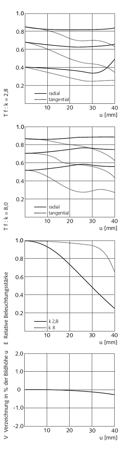

Here is the MTF curve reported by Rollei. But what would one compare it to? Has anyone ever make a lens like this before?
Well, I meant to compare the lenses to each other. On Rolleiflex6000.eu it says that later lenses are better.
