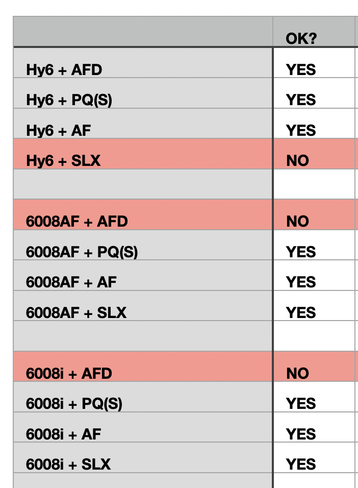

This is a compatibility chart I made for my lenses.
Depending on the type of 6008 lens you have you may or may not be able to use it on other cameras.
AFD = autofocus lens with no aperture ring.
AF = autofocus lens with aperture ring.
PQ(S) = PQ and PQS lenses, manual focus with aperture ring.
SLX = older lenses with chrome trim ring in front.

SLX lenses don’t have a shutter right? How can they be compatible with 6008 cameras?
SLX lenses look like this. You can use them on the newer 6008 cameras, but they won't work on the Hy6.
So basically I can only use my pq/pqs lenses on the hy6 or the leafs.
