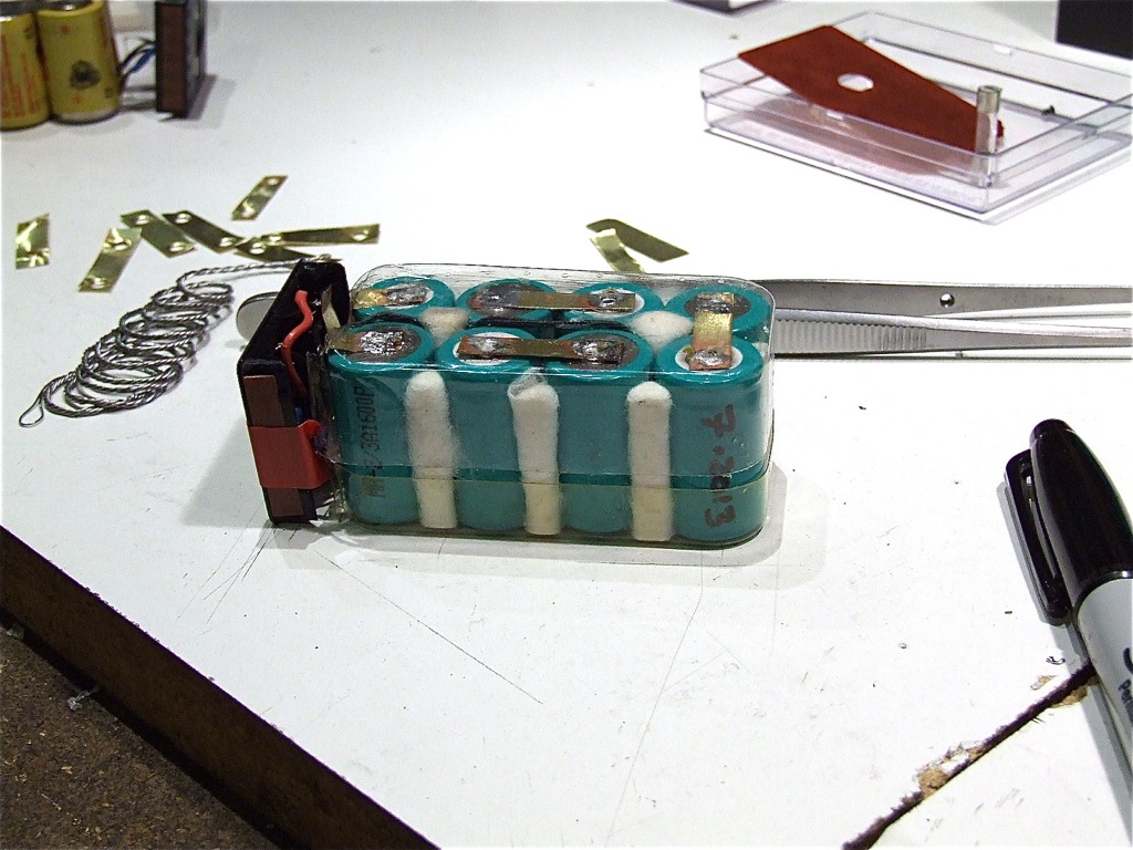

I don't recognize those batteries. The Rolleiflex battery pack should look like this on the inside. There are eight 1.2V NiHm or Nicad cells in series and two thermistors.

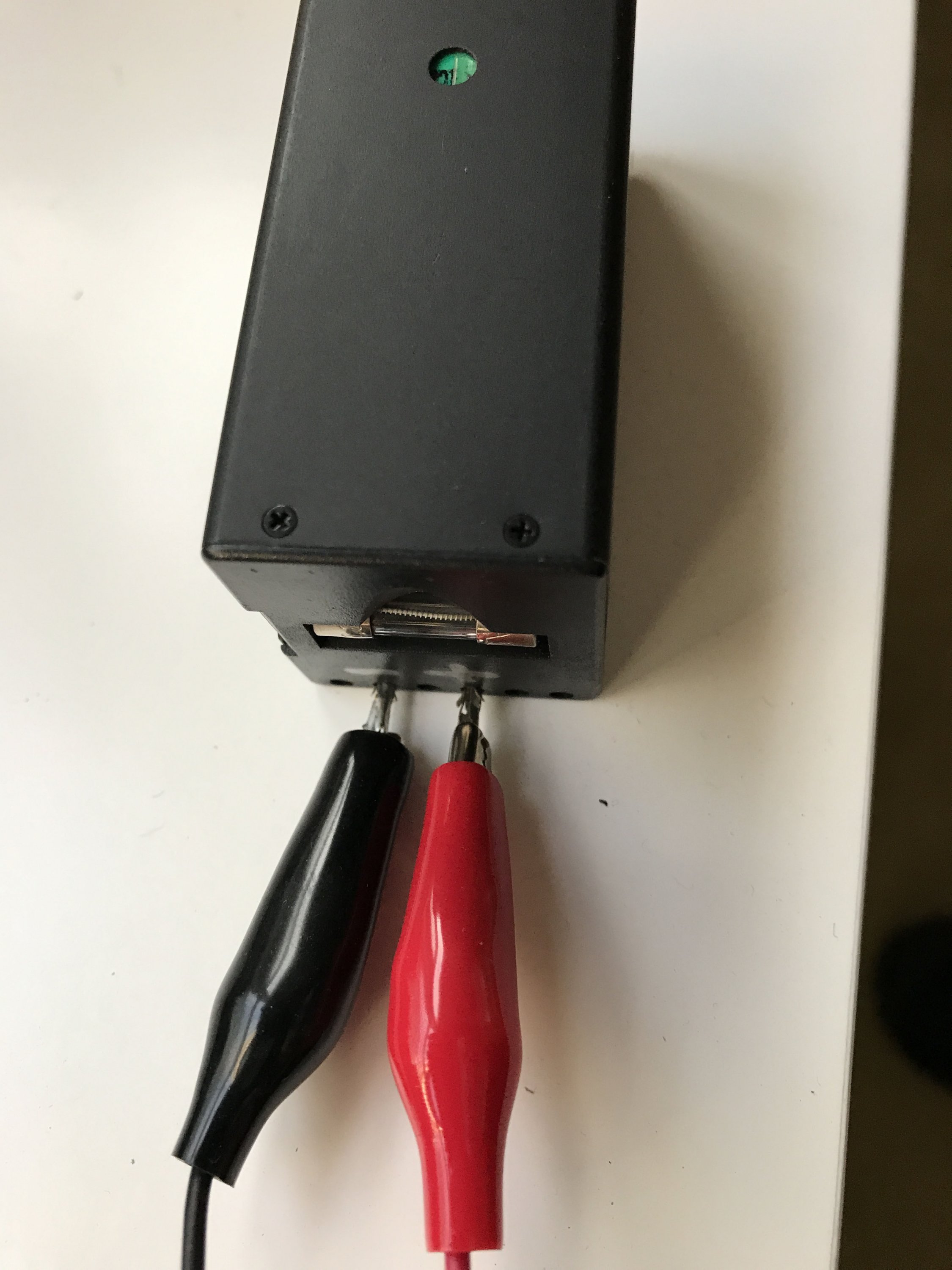

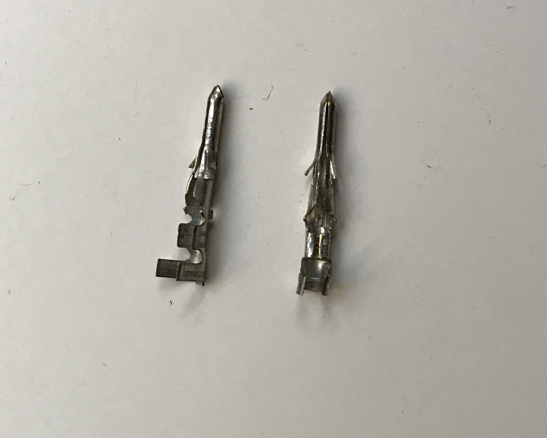

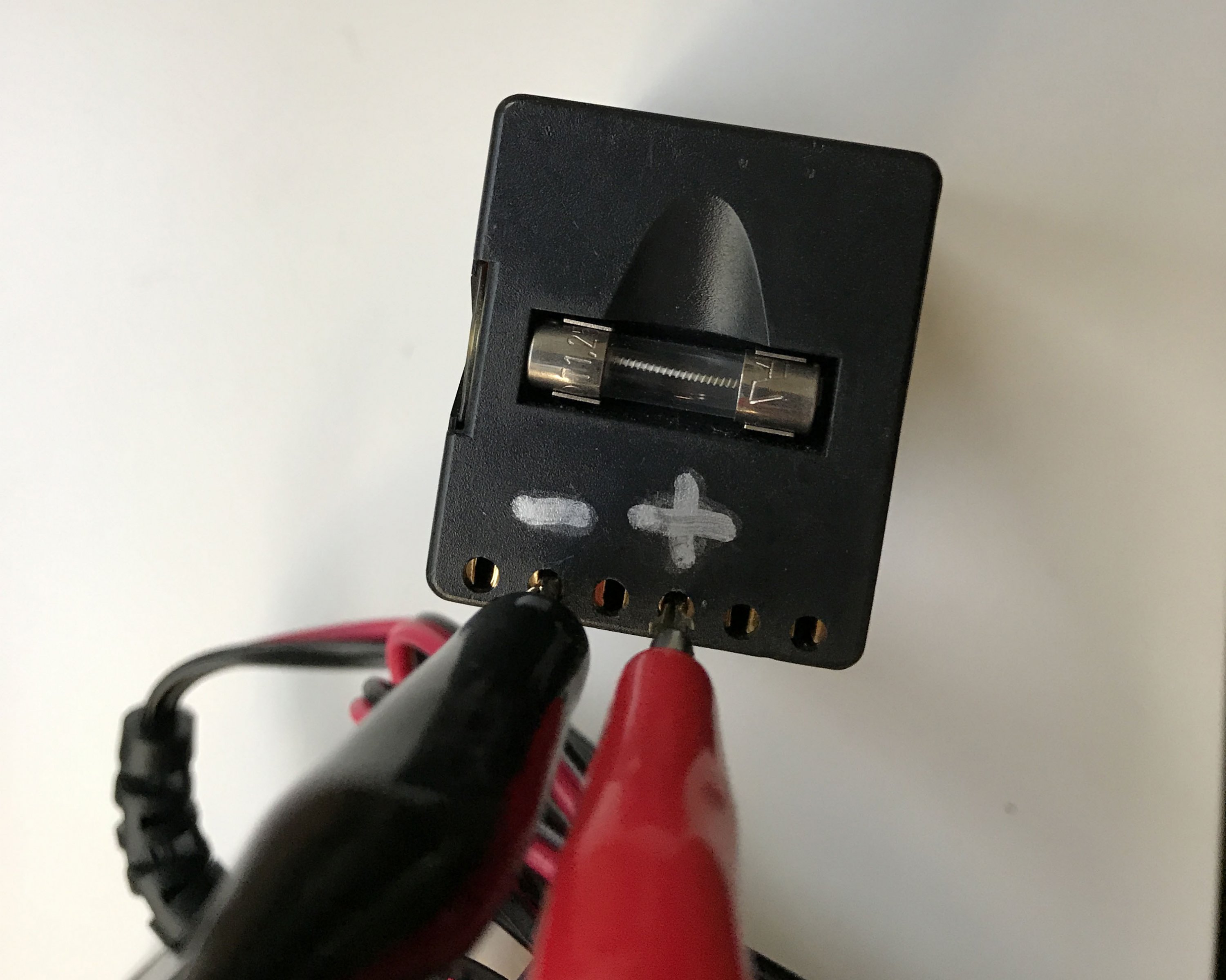

I use some pins I had hanging around in my toolbox, I think they are from multipin automotive connectors. I you could use nails that are about the same diameter as the pins in the Rollei charger.

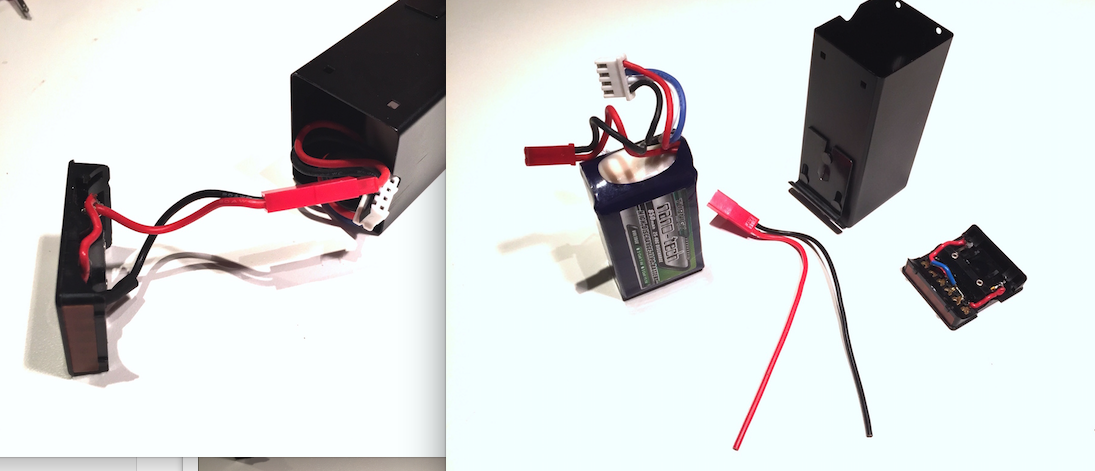

In my opinion the most elegant solution is a 3 cell lipo. I charged mine in Feb. and it is still full charge today.
Did you rig that yourself? If so, would it be possible to get directions and a material list? It would be greatly appreciated.
