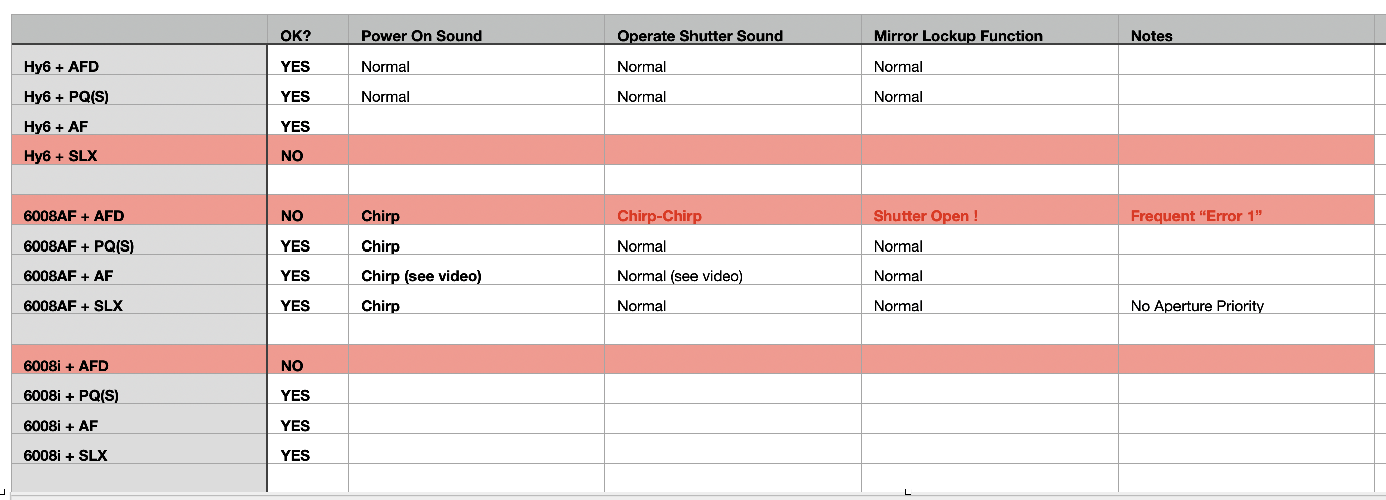

Unless you have a 6008AF, I don't even know if you can use that lens on a 6008i. It's an autofocus lens designed for the 6008AF and the Hy6. It does not have an adjusting ring for the diaphragm, you would have to use it in shutter-priority I guess.
I got my 50/2.8 AFD first, before I got my Hy6 body. In the mean time I tried the lens on my 6008i. It seemed to work but it gave some error messages, so I don't recommend it. It is no good on the 6008AF either. I'd only use an AFD lens on a Hy6 body.

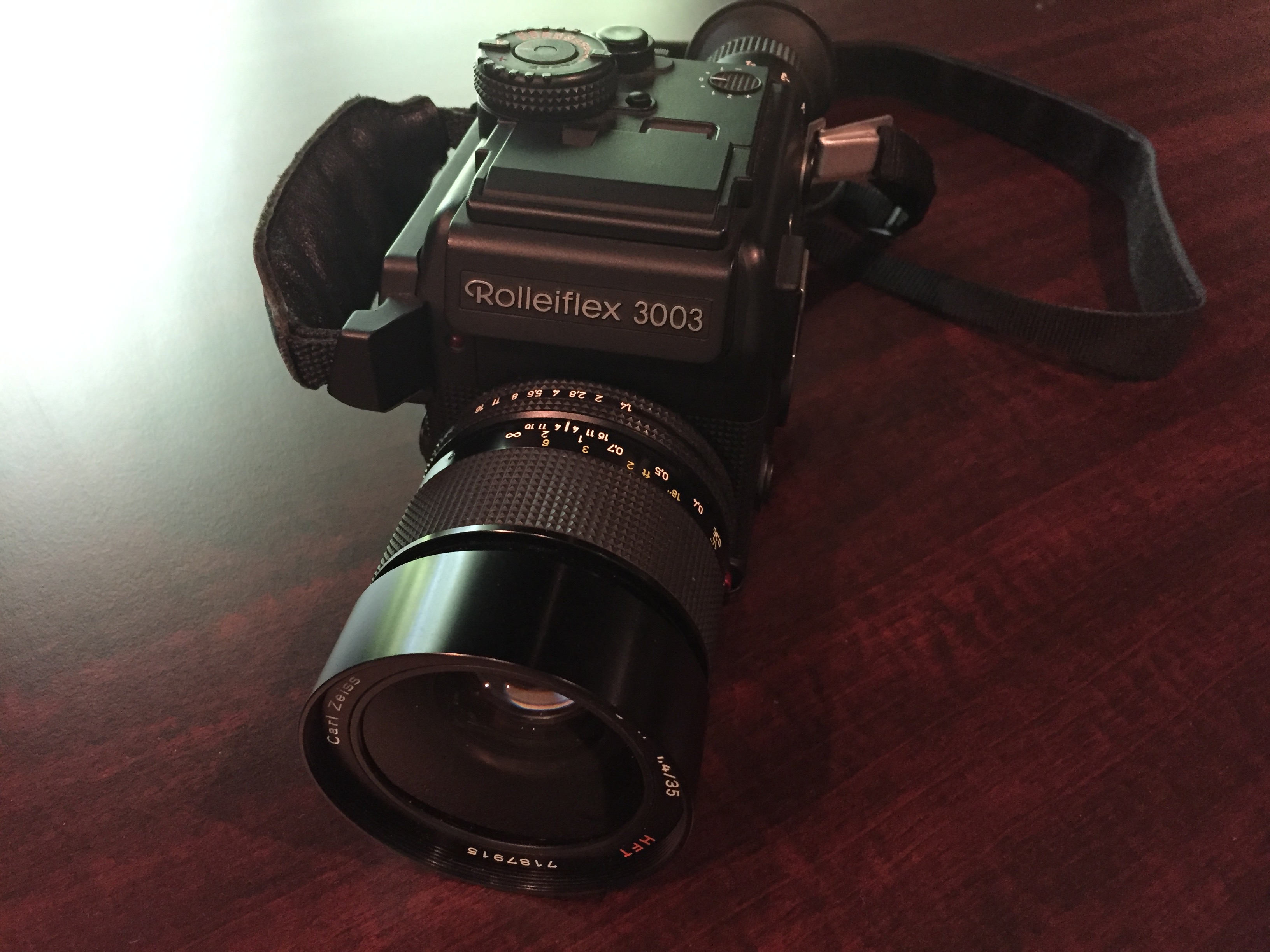

Rollei allows one choose 50, 80 or 180 as one's 'Normal' lens without compromising aperture (they are all f2.8).
They did the same in the 1980s with the 35mm line. One could choose 35, 50 or 85mm lenses all f1.4. In my case, 35mm is 'Normal' so I chose that lens.
