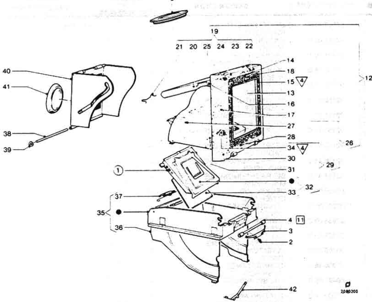

So Saturday out-of-town with my 3.5E and a couple of rolls of film, I opened the WLF to find the mirror lying on the viewfinder screen. I puzzled. I picked it up and tried to figure out where it belonged. Not a clue other than, yes, it belongs in the viewfinder somewhere and has to fold up and down. So I'm thinking the whole WLF probably has to be removed to figure out how to re-attach this thing. Wondering whether this is a big job or small job? Usual no big deal kind of thing, or au contraire... it's big deal (don't try this at home) kind of thing. Appreciate any input. (I have a jpeg of the thing, but haven't figured how to upload here which is in turn probably a good thing). Looks like there are no missing parts... just a missing location.
Thanks for reading.

This may help (#33)

ic-racer: Soooooooooooo we seem to be barking up a few of the same Rollei trees, huh? Well... thanks! This does look both more complex and simpler than I thought. But I'm going to side with the complex part and take another look. Camera is scheduled for a CLA, and may have to wait for that to get this thing fixed. :cry:

Do you use the focus system with the sports finder? That is what it is for. If you don't use it, no need to reattach mirror until it is convenient. It isn't hard to attach once you remove the hood- 4 small scews around the frame. You'll be able to see where it goes right away once you remove the focus screen itself. #33 in the drawing above. Then again, if this isn't your idea of fun and you don't use it....
It is a front surface mirror, by the way, so be gentle, handle on edges only as much as possible.

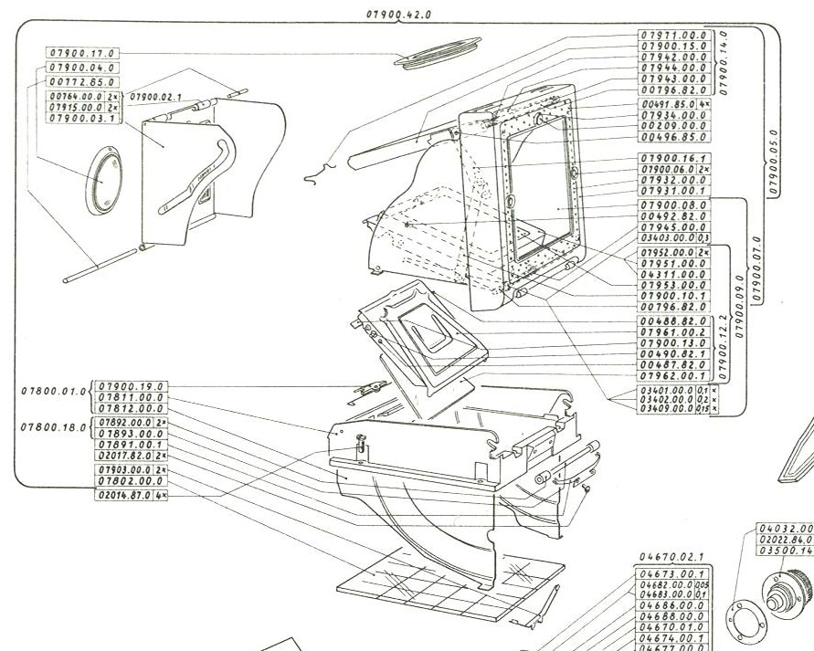

shutterfinger: Yes, I think they're all there within at the bottom of the WLF and in place. Your diagram does kind of scream Julia Swanson's line: "I vant to be left alone." Okay. Will do.
shutterfinger
Feb 25, 2013
5,020
San Jose, Ca.
Please explain.
That's a crop from a Rolleiflex service manual. The line from the part goes to a box. That box is the part number for the piece followed by the quantity used.
Example: 02014.087.0 is the part number for the screw that holds the viewfinder to the body and the quantity used is 4.
I asked about these parts because according to the diagram if the screws and hinge rod come loose may be the reason the mirror fell out.
#42 in post 2 or part number 07903.00.0 in post 8 is the spring that holds the view screen in place and 2 are used.
