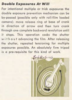

I shot quite a lot on my last trip with my Rolleiflex 2.8F, and on average, 6 out of 10 rolls got stuck after the first frame. I couldn't advance to the 2nd frame unless I shot again, which caused a double exposure. After that, the film would advance normally for the rest of the roll.
I load the camera as per the manual and have never had this problem before. I thread the film through the roller onto the film spool, advance it a bit, close the door, and then advance to the 1st frame until the handle won't turn anymore. That should be it, but something’s clearly wrong.
I haven’t used my Rolleiflex in quite some time, and this is the first time this issue has occurred, but it’s happening quite often. I thought maybe I had forgotten something, but after checking the manual, I see that I’m following the correct procedure.
Am I doing something wrong, or is there an issue with my camera?

Since it's the first frame I suspect that the counter mechanism doesn't engage properly every time. It could be due to old sticky lubricant or maybe a damaged cogwheel tooth. I would recommend that a repairman takes a look at it and gives the winding mechanism a CLA.

Until you get it fixed, you can put a lenscap on the camera when making the second exposure to avoid ruining your shot.
You should double-check the double exposure mechanism to make sure its in the correct position and works as intended.

This is a very vague recollection but I seem to recall discussion, a long, long time ago, where someone commented that the automatic sensing device adjustment could be sensitive to some film stocks. I think it was those with thinner backing paper that may not always register correctly. Not sure if that has anything to do with your symptoms but I mention it nonetheless.

As I understand it, the double-exposure mechanism needs to be engaged for each shot. So, my only guess is that I might be accidentally activating it while loading the film.

@hiroh I have three Rolleiflexes: 2.8F (serviced by Fleenor), 3.5F (serviced by Kanto Kamera) and 4.0 FW (too new to require a CLA). They are all susceptible to this behavior unless you load them with a bit of rigor:
1. When the film is loaded and the back is closed, you advance until the crank stops.
2. Rewind the crank back until it stops again. This unlocks the double exposure prevention lock.
This 2nd step is critical. You need to do this with authority. I used to gently turn the crank backward and kept bumping into the same issue.

Yes, this should always be done. Wind forward until it stops and than back until it stops. It also says so in the manual, that hiroh has read.

If I understand you correctly, I’m already doing that. After advancing to the first frame, I crank back to put handle in its place, but it moves smoothly without needing any pressure.

So if you covered the lens with something light tight for the second expsure on the first frame, all would be well? A lens cap with a hand and shirt away from the sun should take care of that.
I would pay attention to what Steven Lee said about being 'definitive' in winding back after loading. And then if it happens, try what I am getting at- press the shutter release down hard to see if that release the wind system (before any backwards winding or such)(the shutter is cocked by winding the lever about 180 degrees, forward or backward, so pressing the shutter button before any winding is safe- the shutter is not going to fire). And if all else fails, cover the lens (heck, stop down to f/22 just because) and fire the shutter and get on with the rest of the roll.
Something is off, of course. Service would be good, but if you want to avoid that, see what these steps do?

With my first Rolleiflex I experienced this. After loading I wound back only to the point of placing the handle back into the hole. This often was sufficient to cock the shutter for awhile, but then one day it wasn't and the aforementioned problem would occur. Now I make a point to wind back with intention and make sure I can feel the shutter cock.

When I first started using Rolleis I would sometimes hit the double exposure switch accidentally when loading a new roll of film. Then irritatingly it would not advance after the first exposure. Make sure you are not the culprit.
