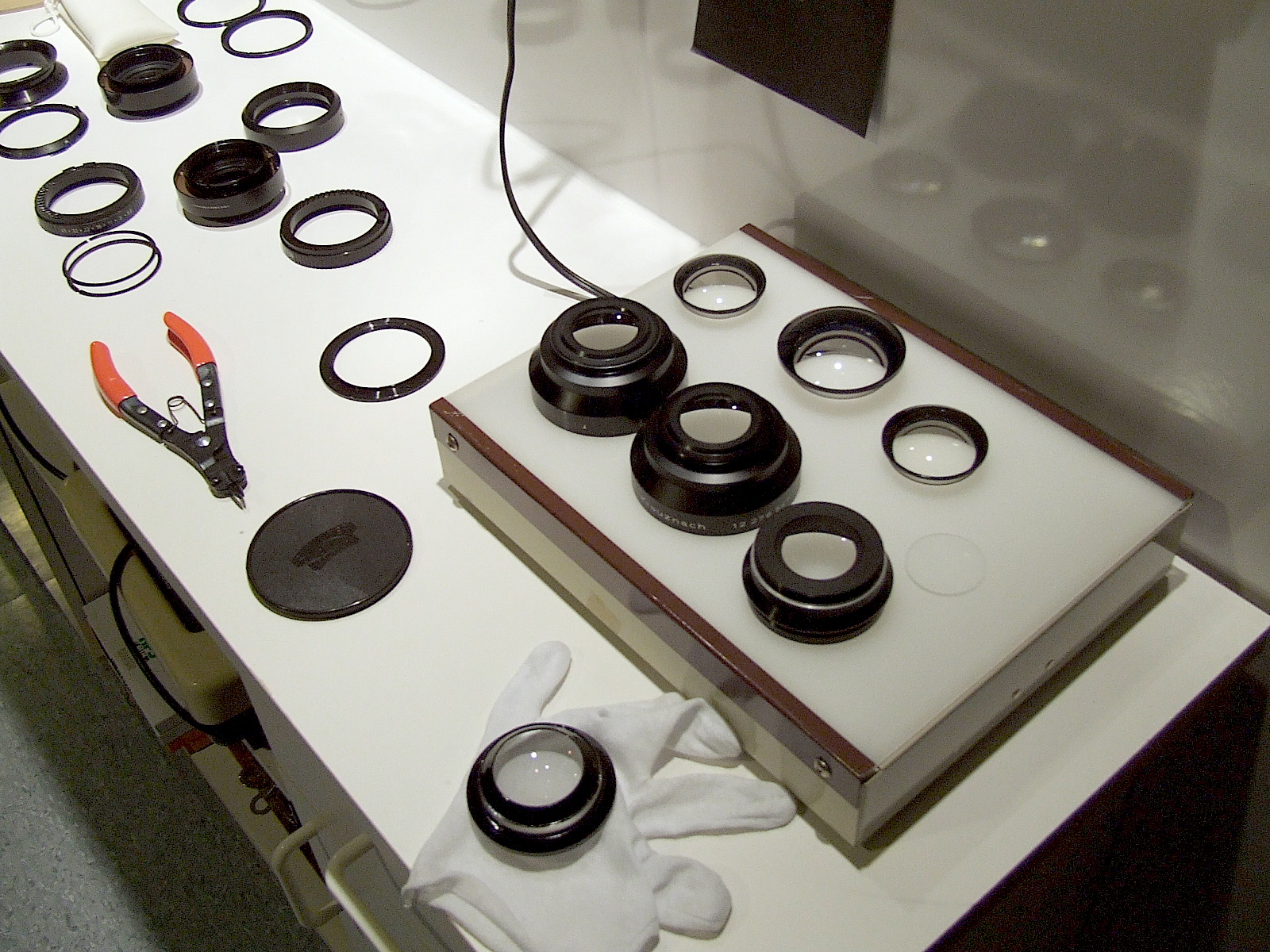

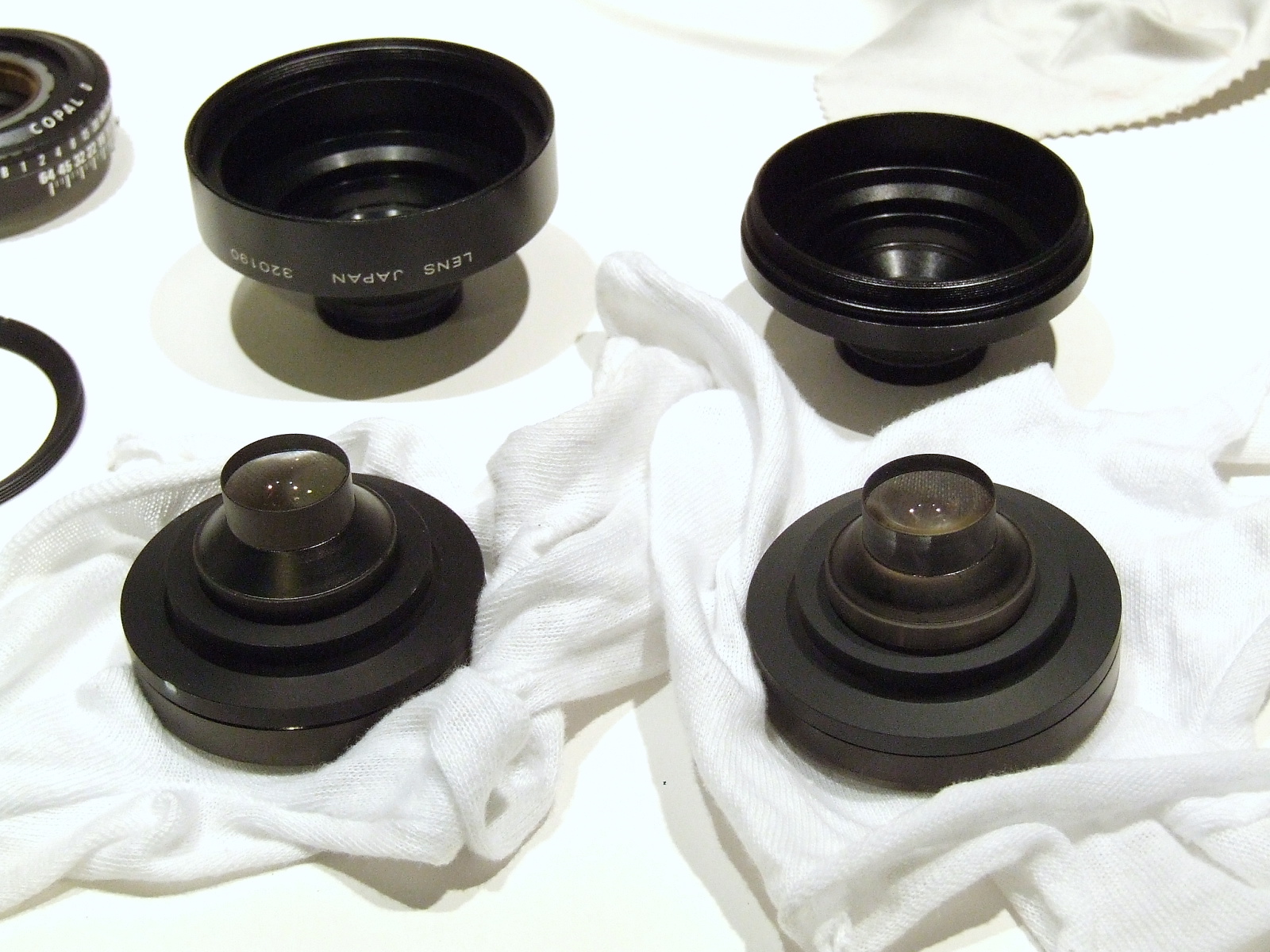

I have done this quite a few times. Usually to get pristine lens elements into barrels or lens housings that fit the equipment I own. As an economical alternative to re-coating, re-cementing, or destroying lens barrels or lens housings with non-reversible modifications.
