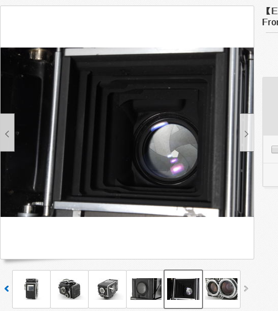

Hi I am new to medium format cameras. After hours of brain draining research I decided to go with the rolleiflex 2.8 TLR. I found one online and my main worry is buying one without a return policy but the one I found is a really good find. From my research the two main concerns are with lens haze/fungus as well as separation. The seller says there is none and only light dust on lens. Judging from these photos do yall think it looks ok. I just dont live in an area where I found one in hand. Any help is appreciated!

Looks nice! Unless the seller has a documented receipt for a recent CLA from a reputable shop figure you’re going to spend a few hundred on service. Which is not a big deal, as that beautiful camera will give you many years of great photos. Enjoy!

Only the last photo comes up viewable, all others are thumbnails and too small to determine anything.
Based on the last photo the front cells are fine, open the aperture to f2.8 and photograph them again with the back open and straight into the lens.

There is more to a Rolleiflex than the lenses. Look at the overall condition of the camera. Check how the back fits against the body. Paint condition on the rim of the raised circle at the wind lever. Straightness and condition of the focus hood. Etc. For your figuring, rough ideas of what problems in other areas will cost you- Shutter, $125, focus $175, winding system- $175.
Looks to be an E? Worth $600-800 base, add for excellent condition, recent overhaul, etc. My numbers might be low because many camera prices have been rising in the last few months.
On an Ebay camera with no returns, best to be certain that either the listing goes over condition, or you ask questions and get in writing from seller. This allows you to return because it didn't match seller's description.

Again, I may be out of touch with the market these days so... $875 for a 2.8 E Xenotar (assuming it is an E) would be medium high. I'd expect a warranty or return option.
For your first medium format, I would suggest that you be careful of Ebay sellers. If they have a few thousand sales and yet aren't willing to take returns, something is fishy. If it is a smaller seller, under 1000 over many years, they might be ok. Look at their previous sales. If they are selling lots of cameras and won't offer a return, I suggest walking away. If they have thousands of sales of all sorts of flea market goods and they say 'don't know how to test, so as-is' RUN. They do this for a living and they know damn well how to test a camera. Places like KEH, Roberts, I'm sure other people have names, will be honest and handle things if something goes wrong. I got my best Rolleiflex by putting a 'wanted' classified in a place like this- a much safer place to buy and sell as both parties are usually more honest and more interested in making certain both sides are content.
Back to the camera above, can you post any full body or other images? Hard to know the condition. Some Rolleis have been in garages collecting oxidation. Some have been ridden hard by pros who knew how to keep glass clean but have beaten the mechanics into the ground.

it looks to have minor fungus starting on the edges of the taking lens, based on the photo in the first post. I'd avoid it. Also, the Planar is a better lens, I'd hold out for a 2.8F planar. 3.5F planar is a nice choice too.

I don't see anything glaringly wrong.
Does the listing say that focus and shutter are operating? In working condition? As I mentioned, it's best to have condition statements in writing from the seller, whether in the leisting or in questions and answers. Asking questions can also give you a feel for the seller.
Yeah, it's a journey. If this is your first medium format camera, you may find that this camera will not be your last. So many different types of cameras, and that nagging feeling, just WHAT is this Hasselblad/Fuji/Maiya/etc/etc thing all about? (and let's just avoid the Planar/Xenotar thing- both are excellent lenses).
Whether to buy this camera or not, again, are you ready to need to put more money into it? Very simply, this is a possibility with this camera. The 'no return' thing is showing up more and more for small time sellers- Ebay changed its policy so that 30 days is required for any returns. For a small seller, living in fear of having to refund $900 for a month isn't worth it so they go to a no return policy. Another reason to get a conversation going with the seller through questions- if there are problems, you'll have an idea of their temperament if you want to return or ask for a partial refund.
OK, just found the listing on Ebay. I'd pass. Japan and no returns puts it in dangerous territory. I'm sure the seller... oh, hey, it says that shutter is not working?? No movemnt in meter? Yep, definite PASS.

The shutter appears to be wide open in your pics. I haven't read all the replies his may indicate a problem.

Yikes- I just read the description. Fungus is noted, lens scratches, shutter and meter inoperable. Pay a few hundred more to a reputable seller and get a good example- it is way less stressful and less expensive in the end!
