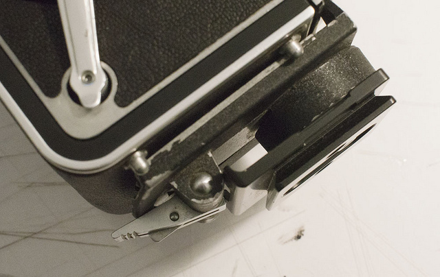

I put an Arca plate on the bottom of my Rolleifix. It's a Markin plate, designed for a DSLR. It has a notch between the two upward pointing tabs that stop camera rotation. The Rolleifix quick release lever can rotate freely because of this notch.
So going on and off the tripod uses the Arca plate. To change film, the camera comes off the Rolleifix.

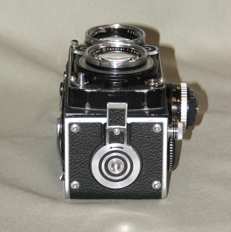

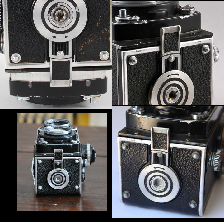

watch out for scarring up your camera if that is important to you.

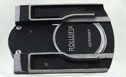

Here is a picture of a Rolleifix where someone has filed off the nubs to avoid scratching up his camera. Problem with this is that if you file off the nubs the Rolleifix no longer gives support against bending the back.
