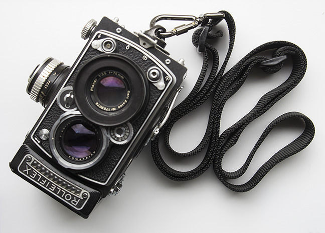

Hi,
I put together an over-the-shoulder camera strap that connects to the tripod socket of any camera, including the Rollei E I have. A friend warned me about bending the back plate of the Rollei using this carrying method and recommended the Rolleifix plate. Looking at descriptions and photos of the Rolleifix, I'm not certain this would be a fix for supporting the camera upside down by the tripod socket. I.e., the E model has the groves around the tripod socket and the two little mounting holes on the front panel, but is that really sufficient to protect the back plate from warping hanging it upside down? Perhaps I'm missing something?
A photo of the strap is attached.
A corollary question would be, does anyone have one they might sell. KEH has a bargain Rolleifix for $40, but that depends on what they mean by "bargain."
Thanks much,
BAB

I wouldn't do either. Your strap looks interesting but swinging a TLR from the tripod mount could risk bending hte back. The risk with the rolleifix is that if the quick-release lever inadvertantly gets flipped -- your camera will go crashing to the ground. My preferred solution was to use a Rolleifix on a monopod and carry it like a walking stick (monopod extended), or carry it like a baby cradled in arms (monopod fully retracted).

I would agree as we'll. tripod socket is intended for a tripod. All thought the strap has a very cool look to it. The risk factor is to great to have that beauty ruined.

The Rolleifix would still stress bottom plate, especially if you hung the camera with it. The bottom plate is only aluminum and easy to bend.
I would strongly recommend that the camera be hung by the strap hangers only, which attach to the body casting..

But would not, when mounted on a sturdy tripod as a coloumn studio tripod, due to leverage when gripping the camera, when cocking, the stresds on the bottom plate be greater, than with the camera just hanging on its tripod socket?

I agree with the overwhelming "WHAT THE HELL'S THE MATTER WITH YOU." :smile:
I'll reattach the old strap, but it's the age of that leather strap that bothers me. Leather rots eventually, and mechanical clips wear out. What I'm referring to are the clips that attach to the posts on either side of the camera. I've always wondered when one or the other is going to break. Is there a way to cradle the Rollei using a strap that uses the tripod mount and also catches the strap-mounting posts?
On the other hand, I do have a monopod and that seems the most obvious solution. Rolleis are forever, but not if thrown on the ground.

Why not feed the straps down, through the origininal hangers, along the side of the body and then connect to the tripod socket?
This way, you would be holding the camera right side up, keeping most of the stress on the original location but giving you extra support from the bottom. I think it would more secure that way.
The down side would be that you have to unscrew the strap from the bottom in order to change the film. Would the (hypothetical) extra security be worth it?
No, I don't think so. The Rolleifix really bionds the bottom of the camera -- face (main frame) and tripod mount -- into a single block to share the stress. It is a fairly robust way to mount the camera on a tri- or monopod. The stress may be the same between pod and hanging, but carrying a camera on Rolleifix upside down introduces the very real risk of the quck release mechanism, ummm... quickly releasing.
Genius. Do that with a Rolleifix for easier film loading and it is even more genius!

The straps I have mount with clips to posts that are on the topside of the Rollei. This is true whether or not the leather case encloses the camera.
Since I almost always use the Rollei with a tripod, I suspect I'll just carry it in one the several packs of various descriptions I have for this very purpose. Not as spontaneous, but using MF is as much a thought process as a mechanical image-capturing process anyway.

I did think of one problem with this idea. If you put a single strap along the sides of the camera, it would be in the way of the controls. The advance lever and the focus knob.
However, if instead of a single lug, you used a square plate mounted to the bottom of the camera with a captive screw that is similar to a tripod mount plate, you could connect four thinner straps to the corners of that plate and route them up the sides to connect at the top of the camera. It would look, sort of, like a letter "X".
You would still have to undo this rig whenever you wanted to reload the camera but you would still have to do this if you used an Ever-Ready case, anyway.
The reason I like this idea is because the standard Every-Ready case is made of leather. I had the leather case on my Yashica Mat come apart on me. It needs to be resewn. (If it can be resewn.) A web system made of high-strength Nylon would give more secure support than the leather without the risk of coming apart.
