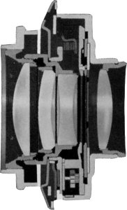

It looks like a triplet with the front element split to allow for more corrections. Schneider did that for their 50 and 75mm 2,8 Xenars in the 1930's. The Xenar is a Tessar type, but the design is similar. They were available as front cell and unit focusing. The 2,8 Xenon on the pre-war Kodak Retinas was of this type, while the 2,0 Xenon was a double-Gauss. The five element Xenar/Xenon is sharper than the post-war four element 2,8/50 Xenar at large apertures.
https://live.staticflickr.com/5219/5471240392_e2cf8fea9e.jpg
