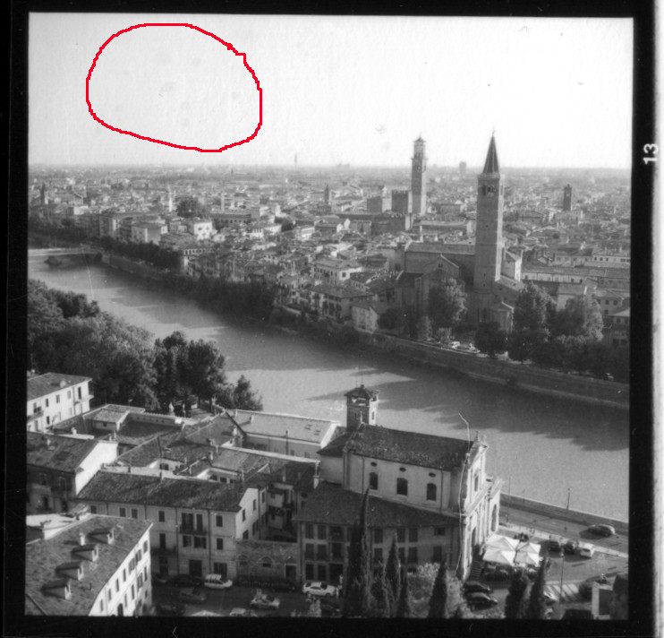

I own a nice Rolleicord Vb with xenar lens. I usually use also a yellow filter and and an original lens hood when shooting outside. However quite often the images show ghosts if the sky is bright even if I'm not shooting against the sun. Is it normal? The lens shows few dust inside. From what I know the xenar should be (single) coated.

What I meant with "ghosts" is that in photographs with bright sky some (almost) round darker spots appear in the sky portion of the photo. I thought it was due to the fact the coating is not as good as in newer lenses but what puzzled me is that it happens also when not light source is present in the shot. I always use a lens hood.
Do you mean round darker spots ON FILM or on PRINT? I ask because it sounds like you may be talking about lens flare but that will appaer as brighter spots on print and darker spots on film.
Another creative possibility is, you may have a very strange light leak which casts a shadow on film.
Can you possibly post an image of film or print, so we can see what you are talking about? I had a Rolleicord V for about a year but did not experience such problems. I doubt very much you have a lens flare either....

Wow, if ever a thread should have been halted until the meaning of the OP was clear.
It is still a jumble because of the uncertainty of the spots being on the film or the print, but the lens is an unlikely culprit and always has been. If it is so bad that black spots appear anywhere, print or negative, the fault would be easily visible on or in the lens. Try it, you can stick all sorts of things on a lens and apart from mild degradation you'd need to nearly cover it in dust and dirt for any major differences to be shown prominently on the print/neg. Something else is happening, and while the description of 'spot in the sky' may still be unclear, a light leak is possible. So the OP should check the tripod socket and make sure that an over long tripod screw hasn't popped the base of the socket and light is leaking in and 'burning' through the backing paper, so fogging the negative.

It's clear my explanation was a bit confusing... Spots are on film and appear as brighter spots on film and darker spots on print. Today evening I'll post a scan from a contact sheet to clarify it.

Unfortunatly I should have thrown away all the corresponding prints. I only found a small contact print but I recognize it's a very bad example. Also the scanning is of very bad quality :sad:. Here the spots look like dirty but on real prints and film they look much more regular. However, as already suggested it might be something wrong with the development process.
