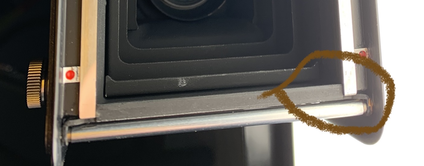

Posted this on the FB group but not great knowledge there. does anyone know if the lower roller on a rolleicord V should spin freely? the upper roller moves no problem but the lower one does not spin. trying to figure out why there is a very faint scratch on the outer edge of my negatives on the emulsion side.

thanks. whats the next step? im guessing the lower roller can be removed somehow and cleaned. i see a bit of corrosion inside on the edge.

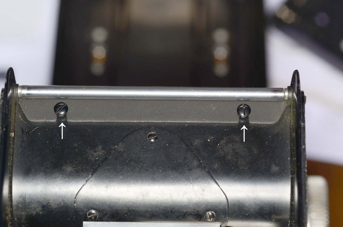

I see both corrosion and a bit of a bend in the frame. There should be 2 screws hold that in place.

So yeah, the lower roller is totally seized up if it indeed should be moving freely. I see some flat heads underneath it which seem to be holding in the frame of the roller assembly to the body of the camera. would removing those allow me to access the roller for cleaning?

You mentioned you saw a slight bend so I put some slight pressure on it spun it--and voila the roller is spinning (although it is grittier/noisier than the upper roller which moves nicely and quietly) i will try cleaning it and running another roll through it.

Film transport rollers should turn smoothly with the weight of a 1/8 inch wide x 1/4 inch long down feather applied to it.
Remove the screws, reinstall with the roller at the same height with reference to the film guide rails in the image frame.
