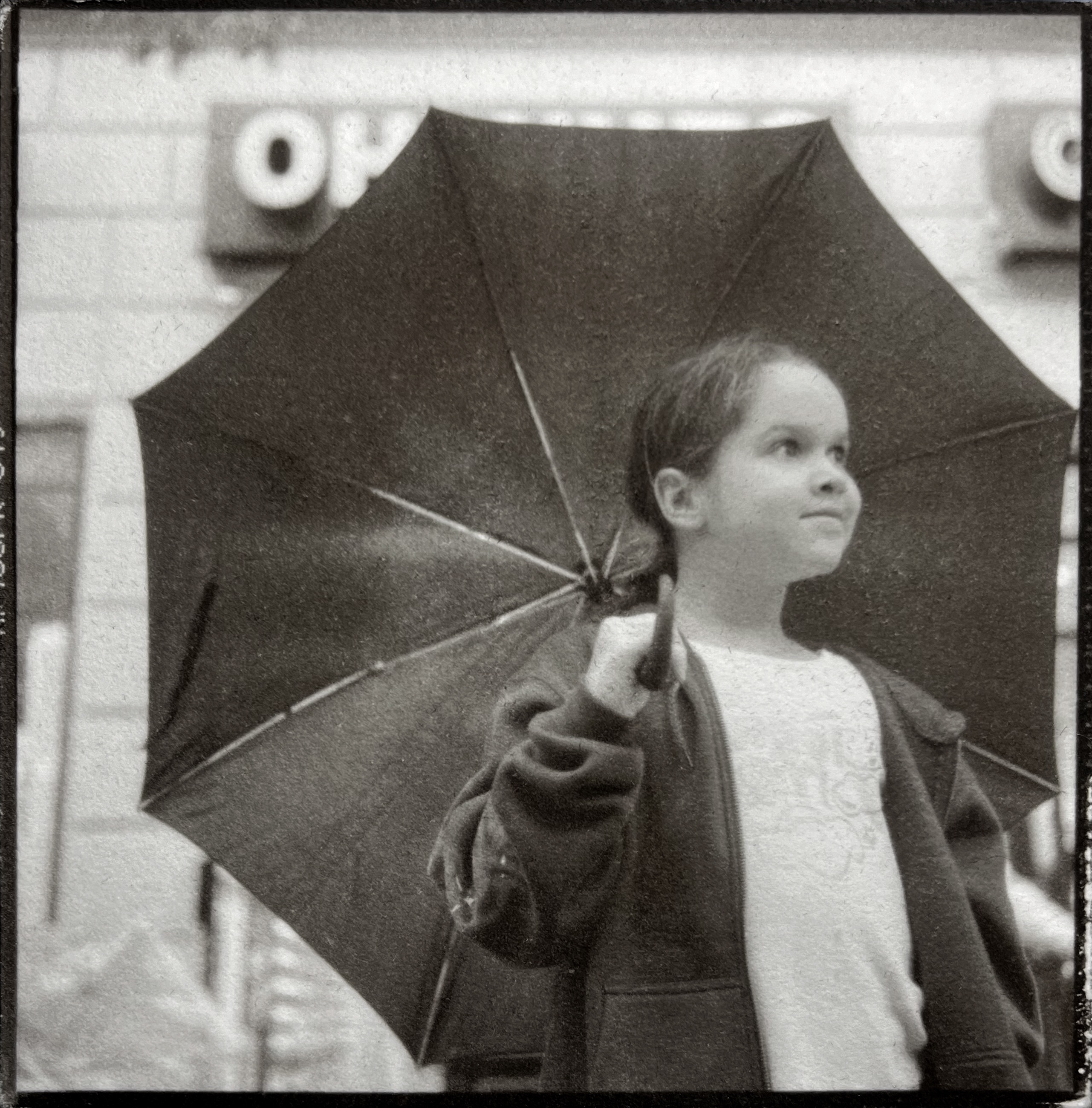

Parallax is the offset that comes from looking at the same object from two different points in space. Anything short of moving the viewpoint to the same point in space will still have parallax. Frames, prisms, etc. are crude ways to give a rough idea of framing changes, not much more.
I learned this the hard way decades ago. I framed my young daughter standing in front of the Oh Nuts! store on Broadway, holding an umbrella in the rain. The Rolleiflex viewfinder correctly showed the edges of the frame. But it did not -- could not -- account for the changed perspective of the umbrella in the frame between viewing and taking lenses. The umbrella did not occlude the sign in the viewfinder, but did block the taking lens's view. Live and learn.
Yes, that! And trying to use the TLR through a chain-link fence!
