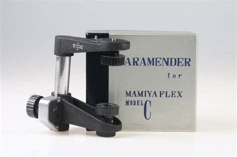

The Mamiya paramenders are designed to deal with the specific distance between the centre of the optical paths of the taking and viewing lenses found on Mamiya TLRs. If you are thinking of using one with a Rolleicord, you should check whether the Rolleicord has the same (or very nearly same) distance between the optical centres of its lenses.

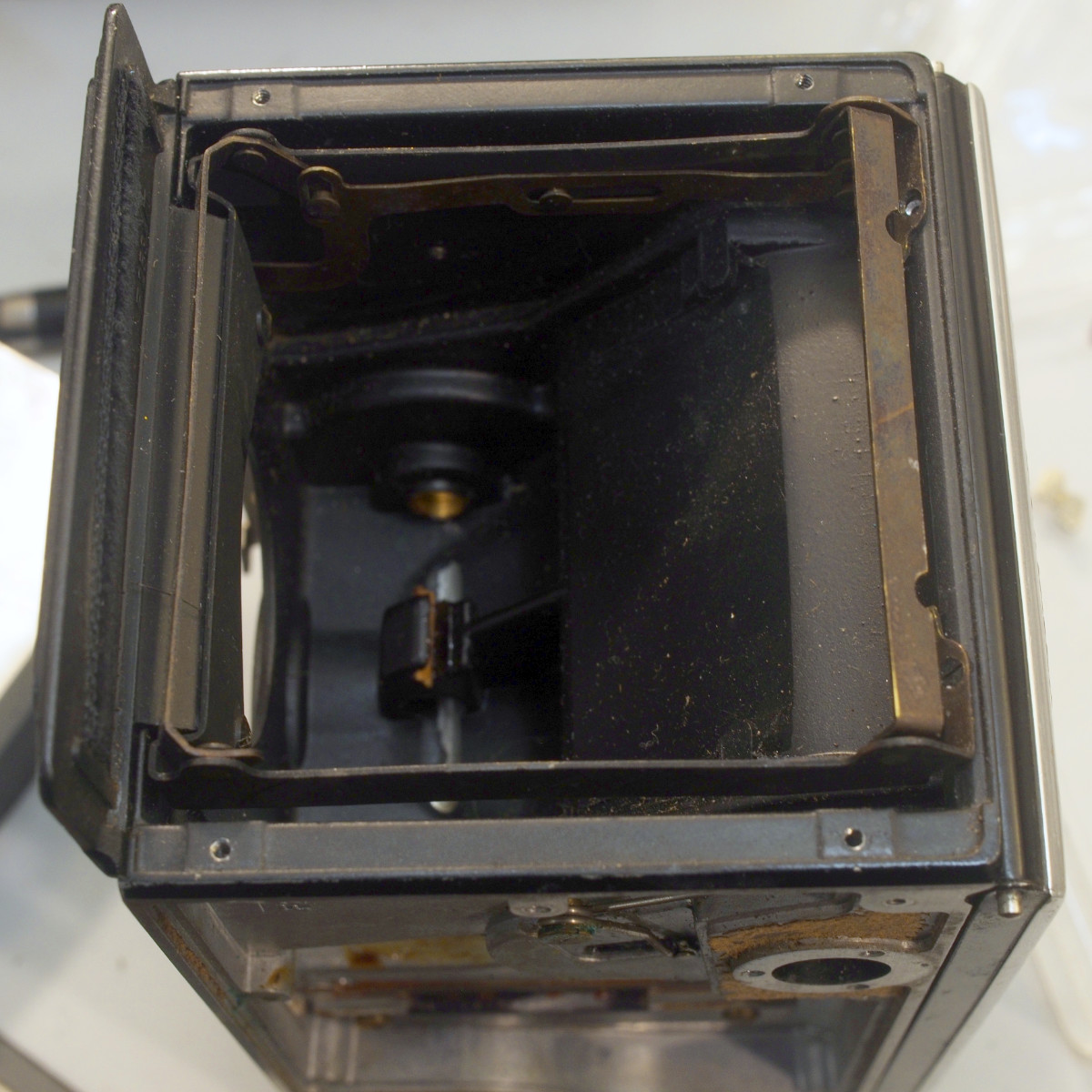

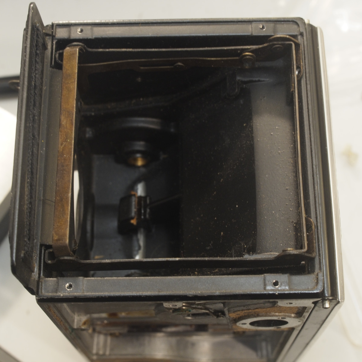

Here's a 'Cord parallax mechanism. The bars are about 4mm, a bit over 1/8" wide. In use they move about this distance, a bit less.
All in all I'd suggest that if you need tight framing on the final negative at close distances, use an SLR?

The paramender can be raised less than full height (for cameras with lenses closer than the Mamiya. )
Also, the distance that the two images (top and bottom) will be discordant is always the exact same as the distance between the lenses irrespective of the subject distance.

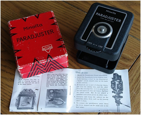

Minolta made a device called a Paradjuster to do something similar to the Mamiya device but set for the right lens distance for the Autocord, which is the same lens distance as the Rolleicord.

Correct me if I'm mistaken, Dan... but isn't that for when using close-up lenses rather than the normal focus range. I always that it was the Minolta equivelant of a Rolleiparkel, although Milolta also made prismatic correction lenses if I'm not mistaken.
Dan Daniel
Jul 4, 2009
2,996
upstate New York
Brian, this would work at any focus distance. It, and the Mamiya mount, is the real parallax correction method, not the ersatz moving frame in the viewfinder or prism and such which still suffers from parallax no matter what you do. So you focus, with or without a diopter as needed on the viewing lens. Then you move the camera so that the taking lens is in the same point in space, move the diopter if being used, and take the photo.
Parallax is the offset that comes from looking at the same object from two different points in space. Anything short of moving the viewpoint to the same point in space will still have parallax. Frames, prisms, etc. are crude ways to give a rough idea of framing changes, not much more.
