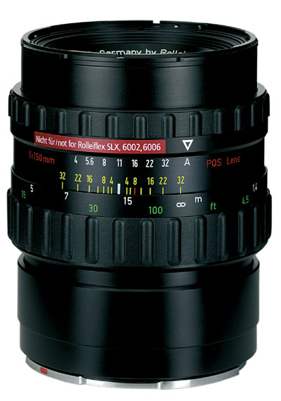

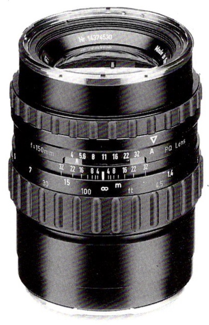

Is it the same lens (especially about image quality) except for the shutter speed? lens-db says so, but I want to be sure...

If you scroll down the websites on your 2 links, and click on the "Lens Construction" links in blue, you'll see the lens optical diagrams. They appear to be identical lenses optically.

Yes, the PQS has a max shutter speed of 1/1000 sec. They are indeed the later iterations of the lenses though I doubt containing any changes in the optical formula but rather, more durable materials for the shutter blades to endure the faster speeds. In the Schneider lenses, the blades in the PQS lenses were made of carbon fibre.
