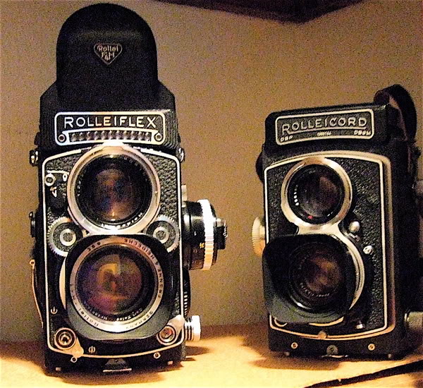

The Rolleicords, while being cheaper than Rolleiflexes, will definitely give great results - especially if you are looking to get into Rolleis for a few hundred dollars or so.
I wouldn't consider one older than a Rolleicord III, and with later models the focusing screens got brighter and some features were added. You might also find a Rollieflex Automat for around the same price.
"Cords are a bit lighter than "Flexes, but still very well-made. Check that the film winding and focusing are smooth, taking lens is clear and shutter speeds appear accurate. If the shutter needs servicing, the slow speeds may be sticky.
I've got a 'Cord III and V with Xenar lenses, and a 1949 Automat with the Tessar, and they all give great results. I always use a hood for the taking lens as the Tessar seems prone to flare in some situations.
RolleiClub web site also has a lot of good information.
