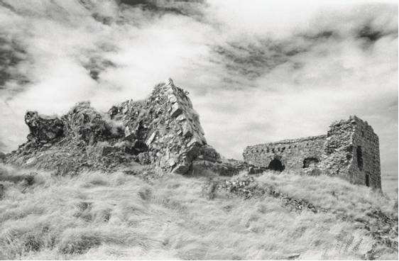

I am surprised at how much of an infrared effect this new Superpan 200 film has produced. Here is a scan from a quick 10x7 RC print I did last night from a roll of 35mm film taken on a sunny day in September with an R72 filter.

cool, how did you rate the film with the 720nm filter?
did you also shoot some without filter?
how did you develop it?
200 ISO without the filter and 6 ISO with the R72.
Yes I did shoot some of it without a filter but didn't print yet.
Rollei RHS 1:9 for 7 minutes at 20 degrees celcius.
