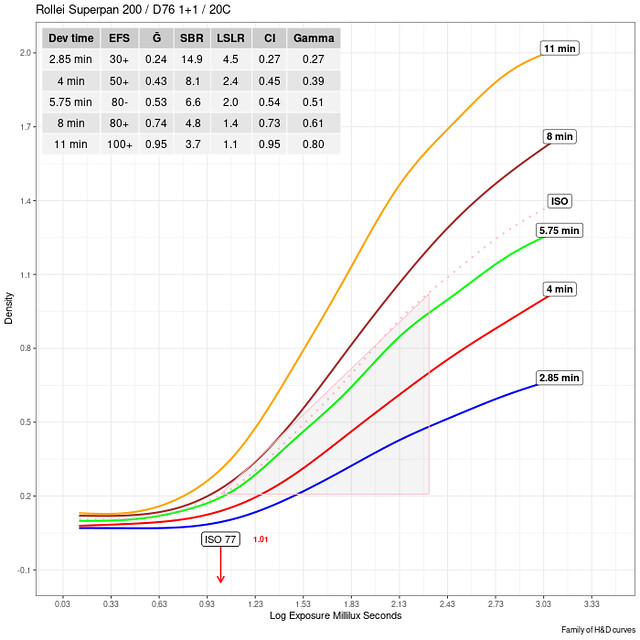

I don't know if this adds anything useful to this thread, but here are my results for Rollei Superpan 200 in D-76 1+1. As all my tests, the five-curve family test was run twice, with the results averaged over the two trials, analyzed and plotted. Processed in D-76 1+1 at 20C in a Jobo rotary tank.
Rollei Superpan 200 in D-76 1+1 by Nick Mazur, on Flickr
Anything you add in regards to this film is appreciated. Thank you! I'm still waiting for you to make your curve plotting app available... 😉
