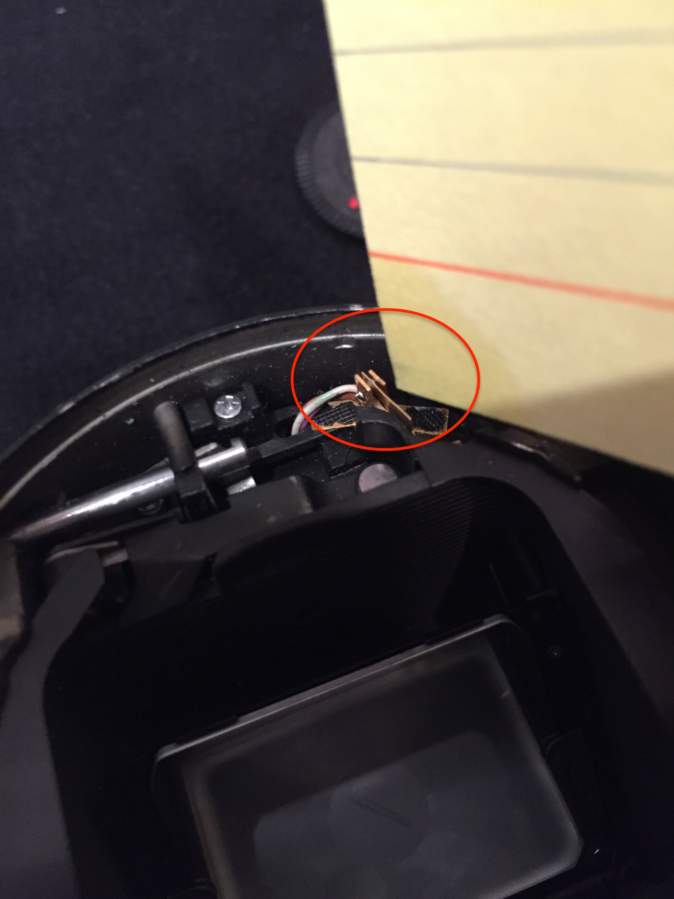

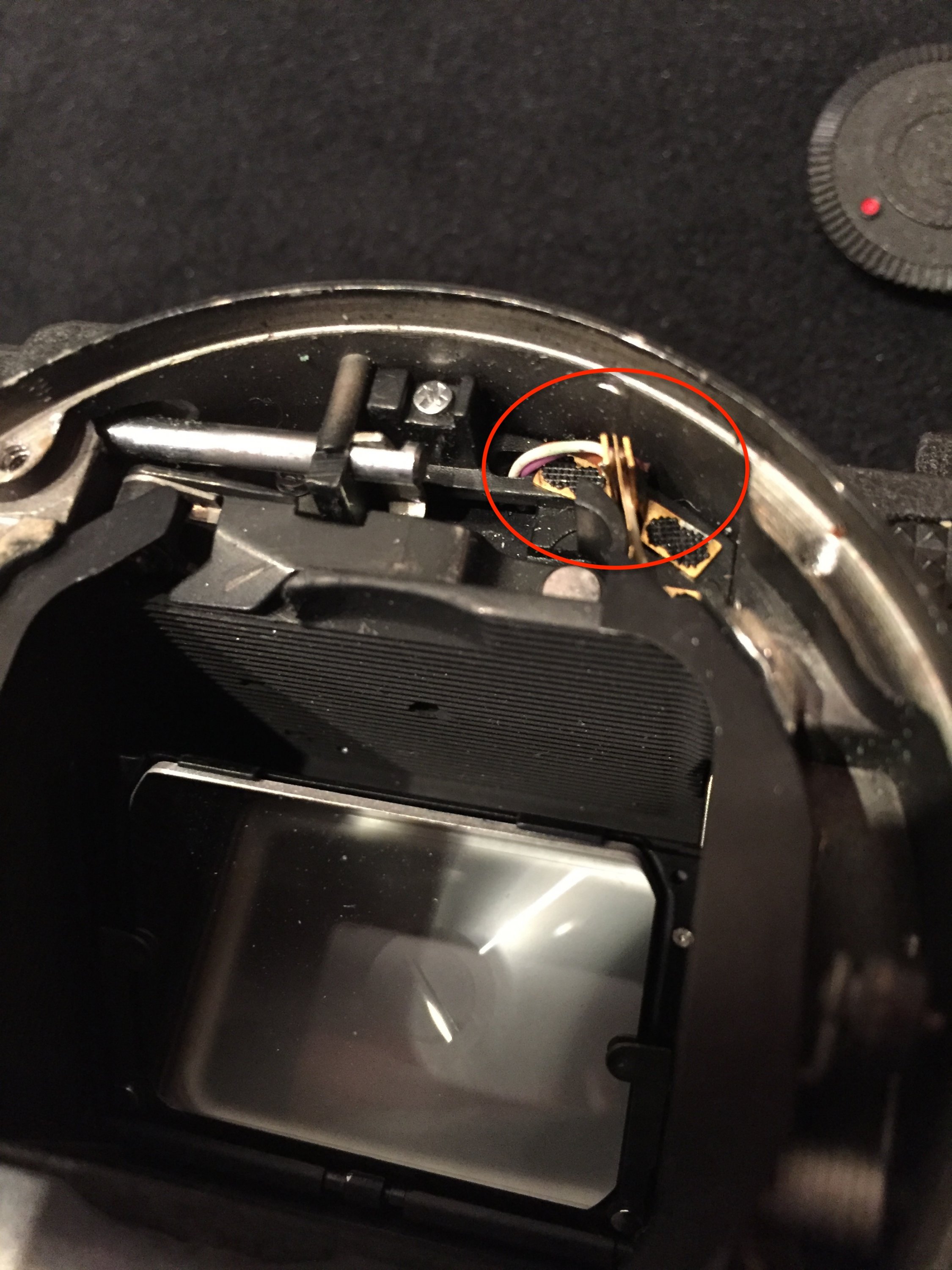

What had happened on two of my SL35M bodies is that the the contacts of microswitch S2 that are OPEN when no lens is attached became dirty. Perhaps because these contacts are visible in the lens mount and are not protected when there is no lens.
I used some DeOxit on an index card and passed it between the contacts to clean them. Now the meters work on both camera bodies!!

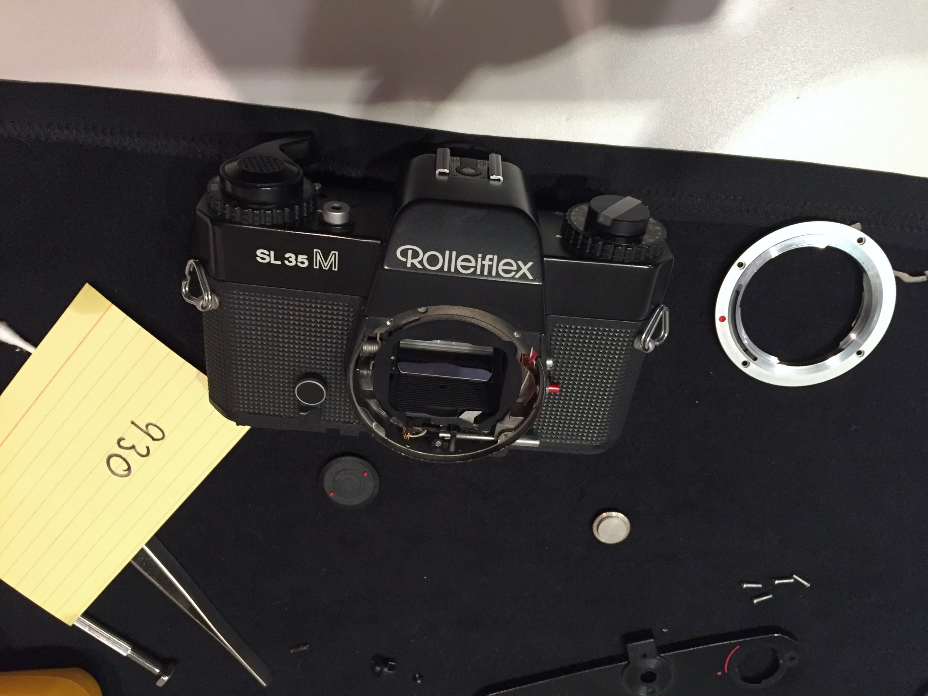

Here is serial number ...930 undergoing the repair.
