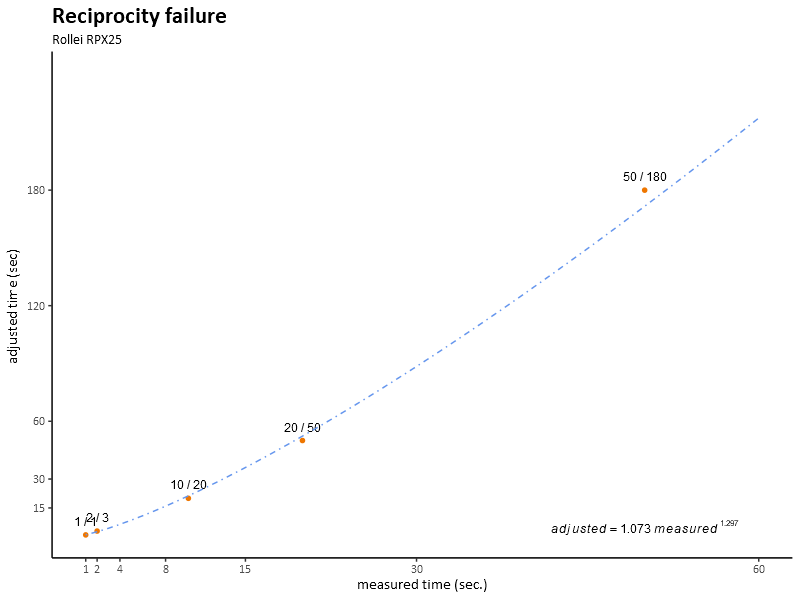

I had downloaded the English translation of the Rollei datasheet; thanks for sharing! There are some reciprocity failure data points, but rather unusual - I mean, what sort of exposure time is 10 seconds? Isn't it supposed to be either 8 or 16 seconds: :smile:
The points at the chart do not correspond to the quoted times either.
But I took the data points, crunched them in my trusty R Studio and came with an equation that seems to fit them rather nicely.
Now the big question: time to apply all this in practice!

I had downloaded the English translation of the Rollei datasheet; thanks for sharing! There are some reciprocity failure data points, but rather unusual - I mean, what sort of exposure time is 10 seconds? Isn't it supposed to be either 8 or 16 seconds: :smile: The points at the chart do not correspond to the quoted times either.
But I took the data points, crunched them in my trusty R Studio and come with an equation that seems to fit them rather nicely.

Notice Fire : As I see you followed the
recomandation from the datas given at
Rollei's side.
They stated you have to extend the courve to times you need - am I right?
Ok - now we are in concern to
"curve discussion" :cry:.
I was no genius in mathematics but
I remember these curve discussions. ..
from school. ...:sick::sick:..:sick::sick:!!
As I know scharzschild you have to add
the time.
In other words : When you have very long
exposure times the sensitivity of your
emulsion goes down in a logaritmic function.
The exposure times you have to add wiĺl
expand more and more.
Hope it is not in wrong direction but it is
quite logical and I have it in mind so to many years.
THAT have nothing to say...hmmm:D:D:D.
So back to photographic practice :
You should have an exposure series.
Like : 50sek./1min./1min10./1min20./
a.s.o.
Back in darkroom you look at results.
At least I would have a look on the
curve to check If your curve is correct:happy:.
with regards
I forget to say : If the extention of your
curve is correct you have following
adjustments in time - look to your curve:
You want an exposure of : 2min - ok?
The curve (within adjustments) at 120sec. showes quite clear a messured
time of : 37sek. this is your basis of
aperature setting!
Exposure time to your shot is 2'00"
everything clear fire?
