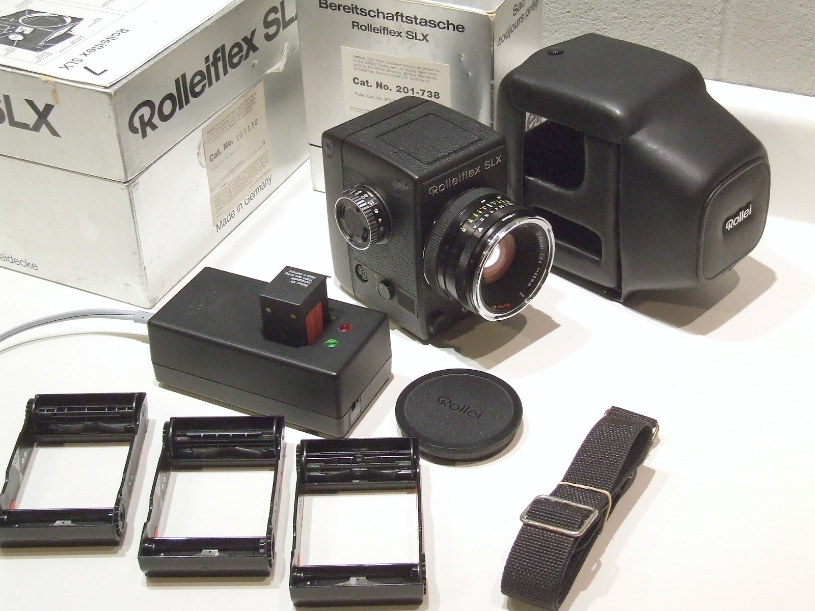

I got mine around 1986 and sold it in 2013 with all these items. Including the original box and the rare Bereitschaftstasche!
Kind of sad to see it go, but I replaced it with 6008i, 6008AF and Hy6.
