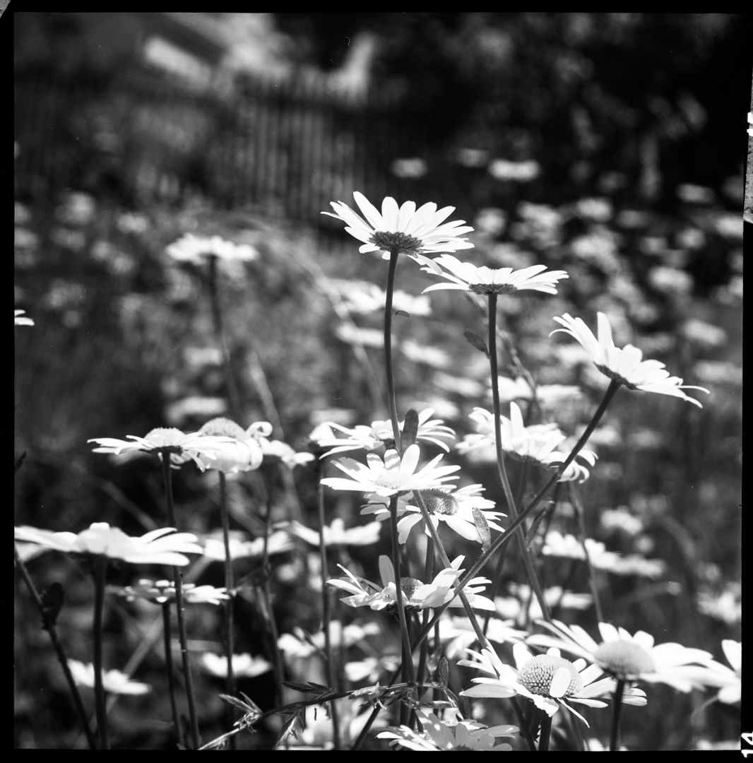

Hi
I am out of ideas and would need some help.

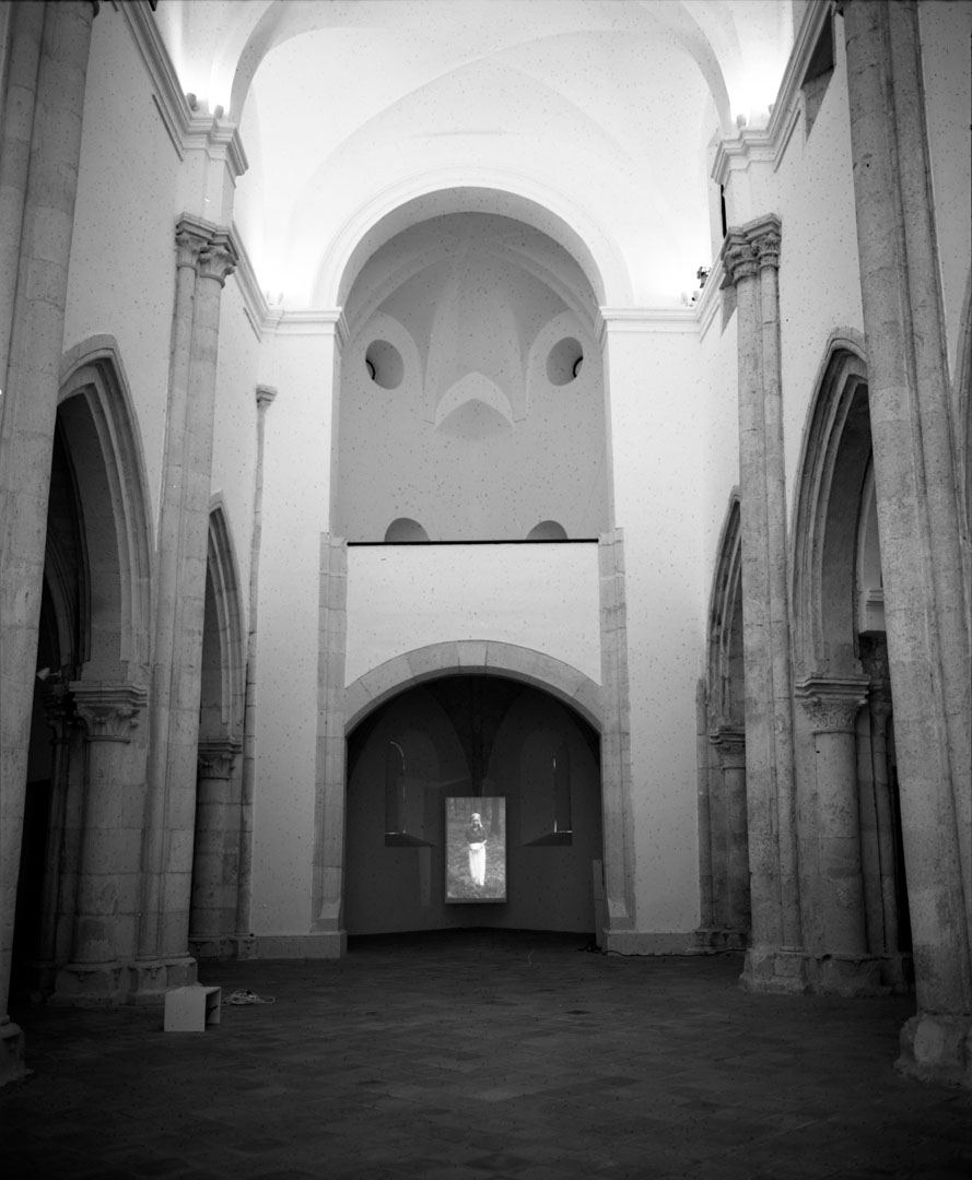

I have black spots on the print/scan from Rollei 80s on 120.
The spots are all over the image, tiny and on the whole roll thru.
I am using Xtol 1+1 dilution, no presoak, fix, water rinse and photoflo.

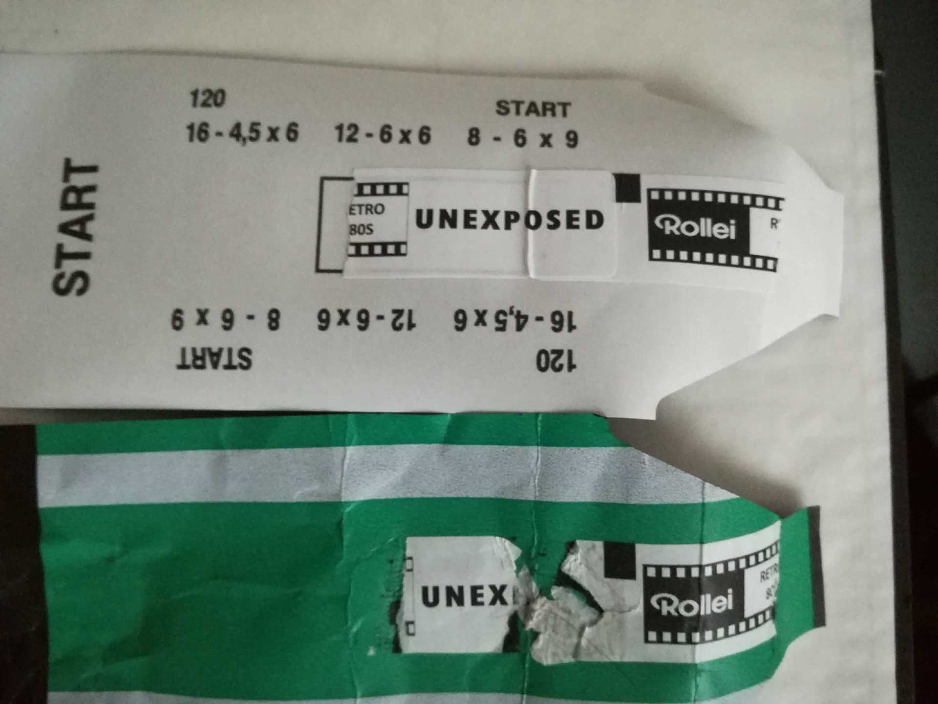

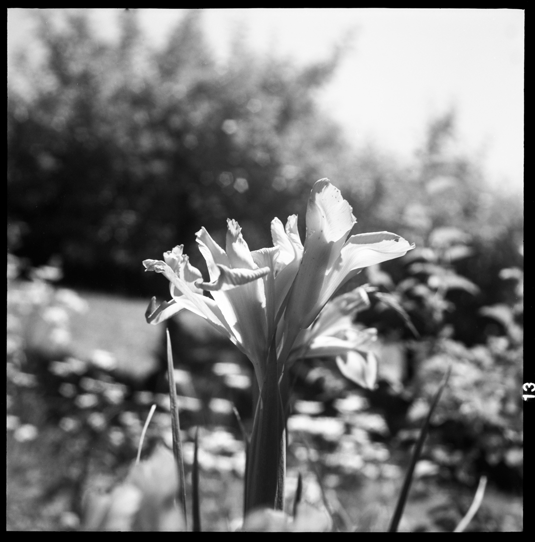

I didn't realise but I still used my previous batch with the expiration date 2018 and NOT with the 2020. I just developed a new roll with the 2020 date and its fine. I did use a prewash but i doubt i made any difference. The new batch has a new backing paper. Its white instead of black with a green leader.
FlexaretVIa_Rollei80s_80iso_052017_033.jpg FlexaretVIa_Rollei80s_80iso_052017_034.jpg
The new rolls also dry flatter and now they are just fine. Sharp, contrasty. I shot them on my Flexaret VIa, used different filters and closup lenses, I developed this roll at 50 ISO in Xtol for 7'30 min at 24°C with the above mentioned technique.
