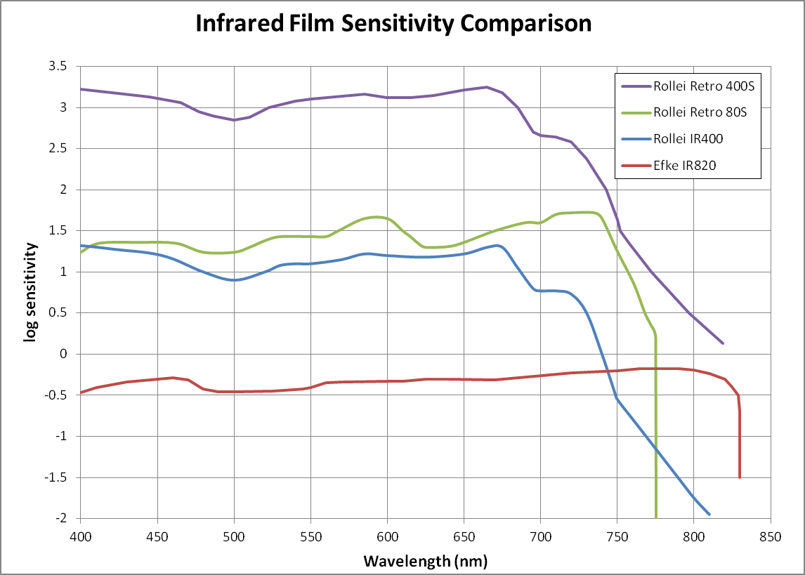

Regarding Rollei Infrared 400 (supposedly done by Ilford), I ran a roll through my Ikonta yesterday and surprisingly it doesn't appear very fast. Not as fast as Rollei Retro 400s at all. Only a three or four frames came out usable because I had been liberal with exposure and used bulb fill.
It's not impossible that I did something wrong in development, but I doubt it. Most of the negative are mostly thing with a hint of flat. Hinting at underexposure and perhaps the Massiv Dev recipe is wrong or out of date, giving it too little time.
I saw this curve in another thread on here:
https://www.photrio.com/forum/threa...heliopan-filter-for-rollei-ir-400-iso.118567/
The guy posting it questions it's validity, but still it seems there is something to it.
Apparently it originates from Digital Truth. But I can't seem to find it in their collection of articles on IR film, which are now of varying quality anyway: https://www.digitaltruth.com/articles.php
The curve of IR 400 and R400s seems to mirror each other closely in the chart, only with significantly slower speed.
It's not just my sentiment and the above image, but also something that pops up again in other threads and articles on the film, when you do a search. IE. people being surprised at the slowness of the film.
Strange to have a film that is supposedly markedly slower at IR than the others in the roster, and then call it Infrared specifically.
Is Infrared 400 really Retro 400s, or something else?
It does in fact seem slower than even Retro 80s or HR-50.
I'd probably consider rating it EV 6 - 10 if I shoot it again.
