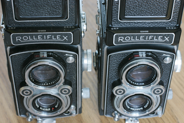

Here is a pic of two MX Rolleiflex's; they have the "R" instead of the "B", and were made between 1951 and 1954; an Automat X (K4/50, 1949-1951) also has the "R", but an MX-EVS (1954-1956) has the "B".
Edit : these MX cameras are the earlier (1951), with serial number 121.... and 122.... ; a later MX, with number 126.... (~1952), and a 2,8C, with number 129.... (~1953), have the "B".
