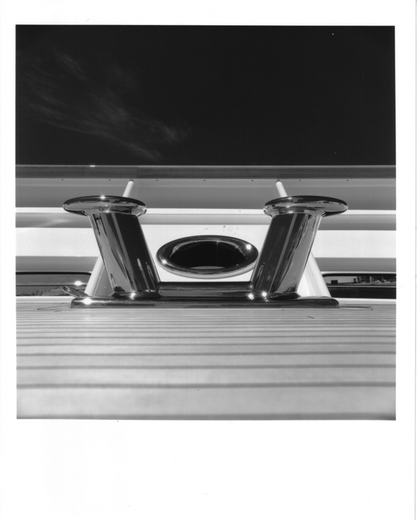

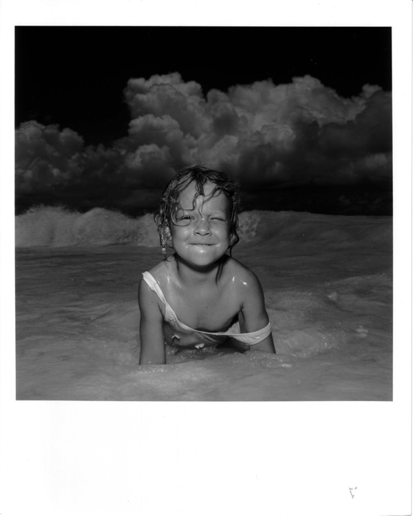

The bollard, or cleat, is Pan 25 at EI 25, the absolutely wonderful child is Efke 25 at EI 25. The Pan 25 had to be coaxed to an acceptable density, so I assume I'm underexposing the Rollei. Both in DD-X at 68 degrees, the Pan 25 takes 9 minutes, while the Efke takes 10. I love the Efke for my purposes.
Sorry the comparison is of different subjects. I'll try to shoot a single subject soon and post.
