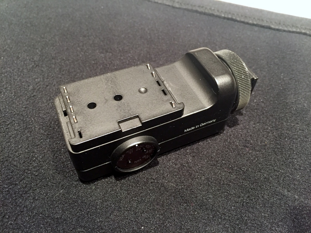

I got a Metz 54MZ-4 to use with a SCA 3562 adapter and Hy6. I thought it would be nice to use the flash on older Rolleiflex equipment with the SCA 356 adapter. I found one 'new in box.' Turns out it works but some of the functionality did not work all the time. The little lightning bolt sometimes did not show and the function where the shutter speed on the camera is automatically set to 1/90 did not always work.

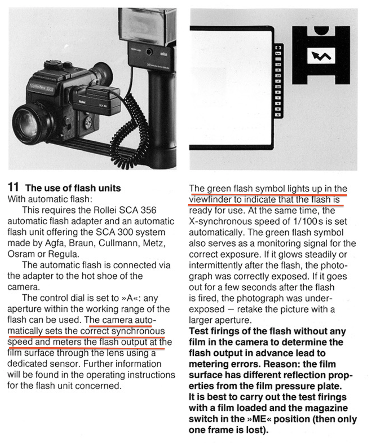

The SCA 356 gave correct exposure but the indicators in the finder were not visible. The shutter speed would not go to 1/90 when the flash was turned on. Still useable, but I wanted all the features. These functions initially worked, but after a few exposures, they stopped working, then started working again. Loose connection? Cold solder joint?

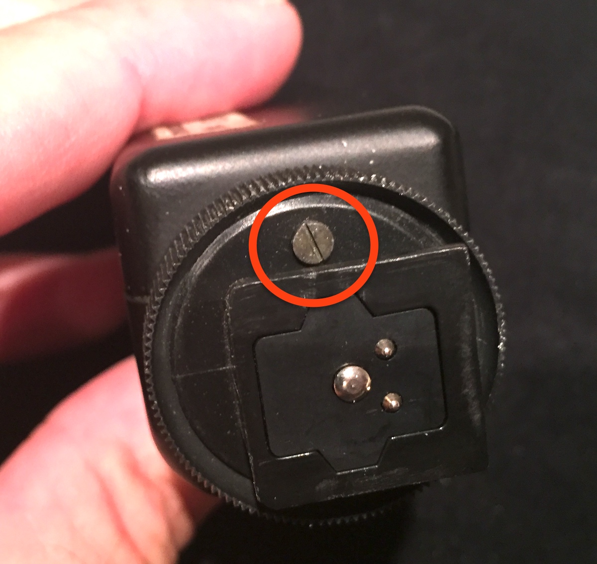

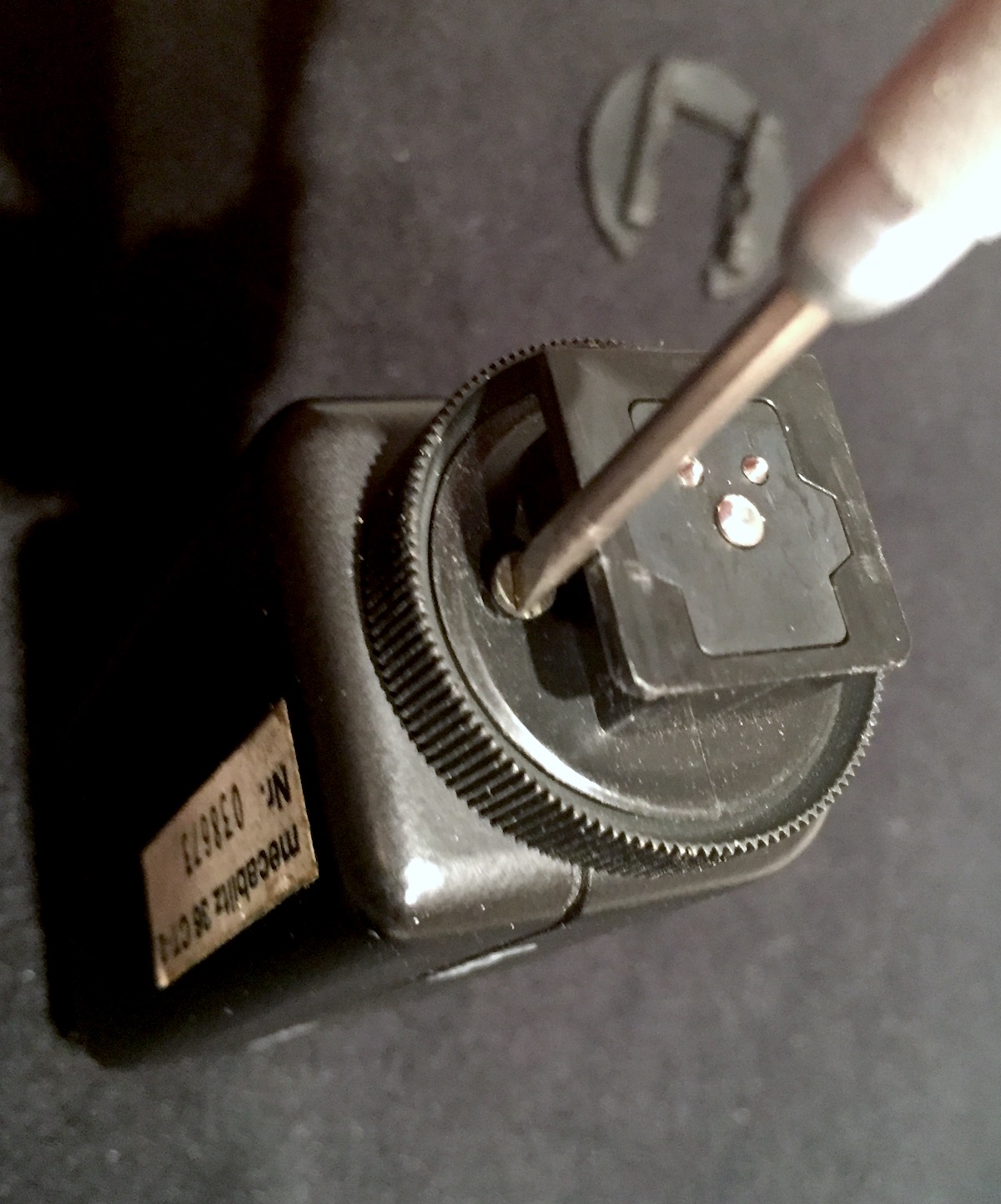

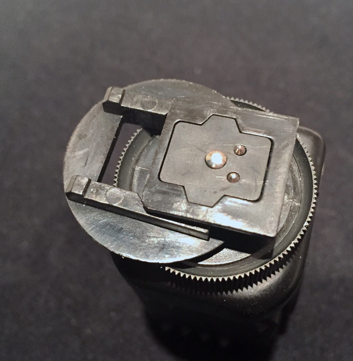

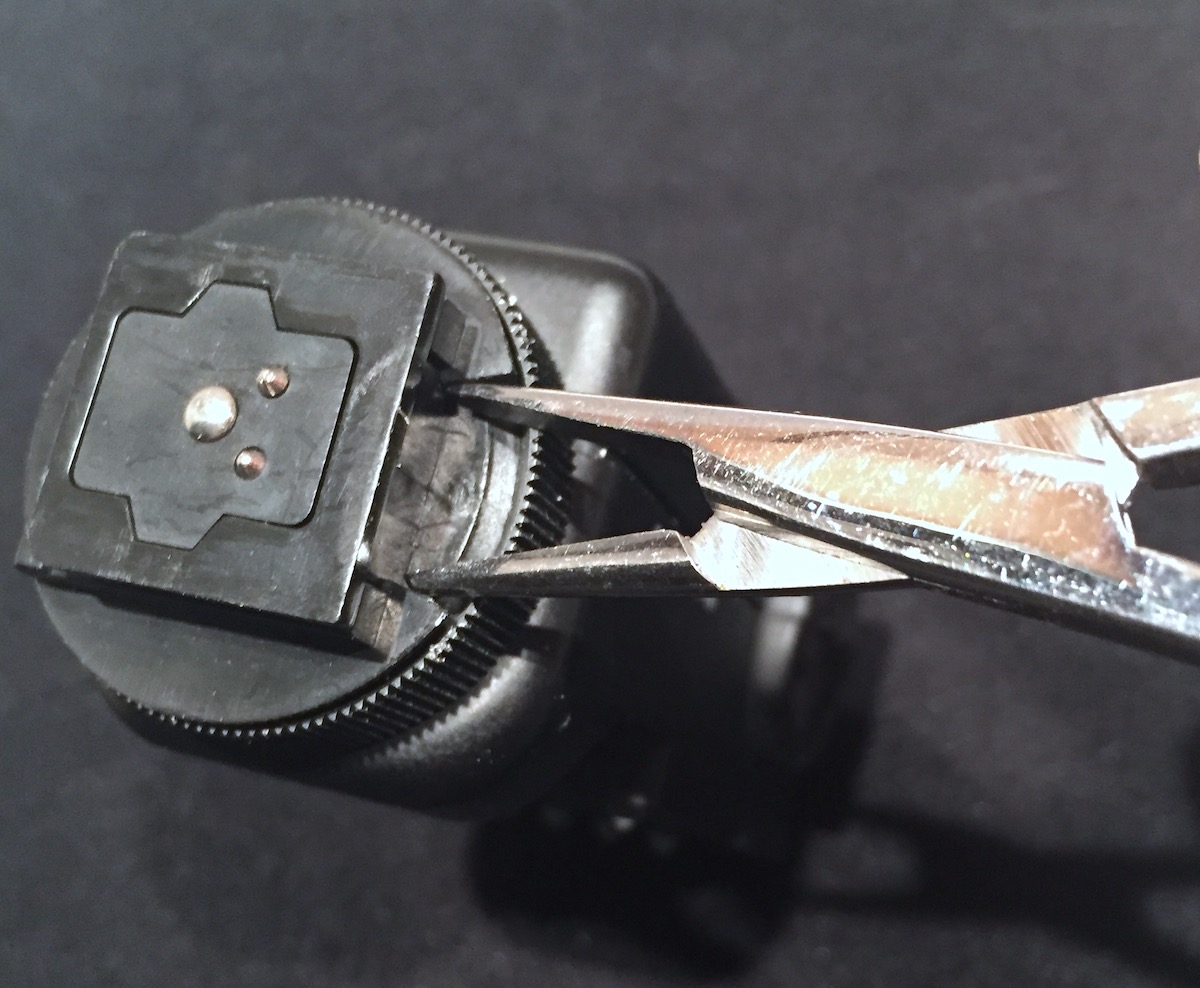

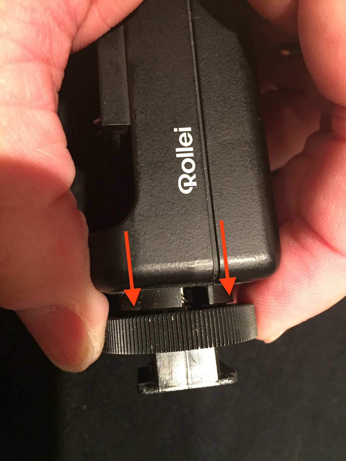

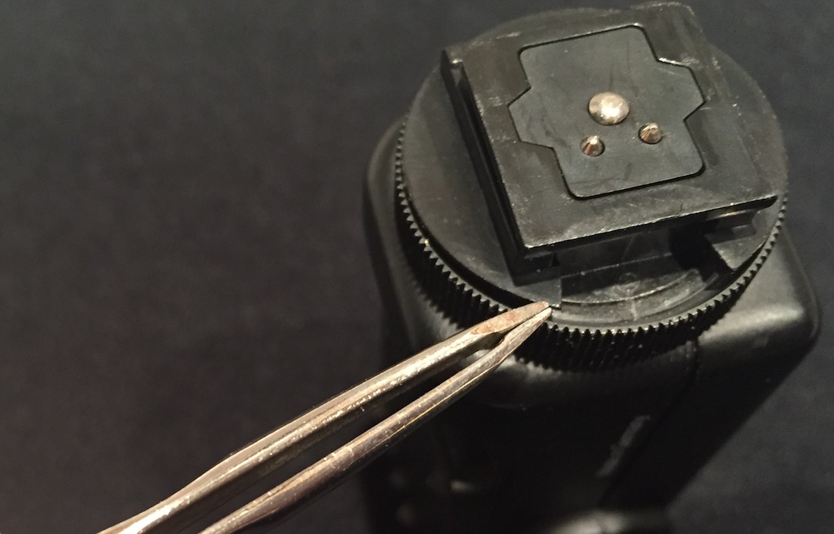

Slide the keeper off the get to the screws:
After removing the screws, slide the entire shoe forward so the two parts of the case can come apart. Caution: Wires attached

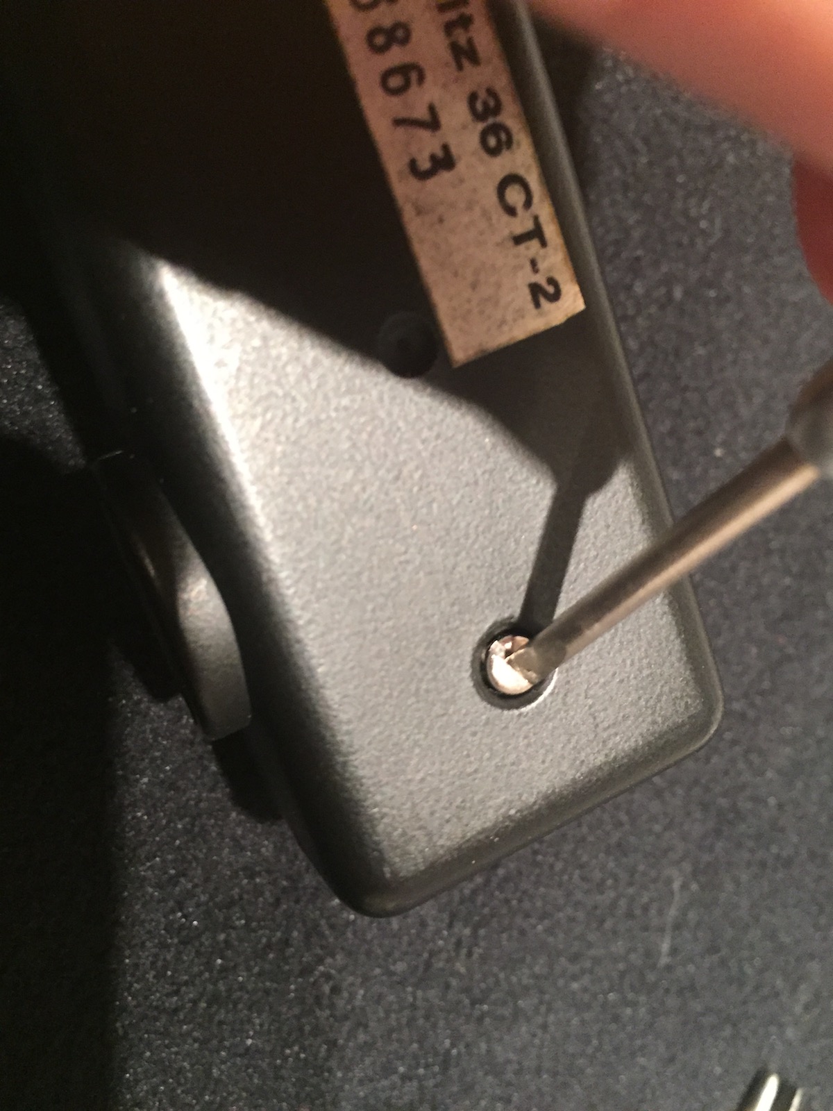

Now the one visible screw on the bottom of the unit can be removed.

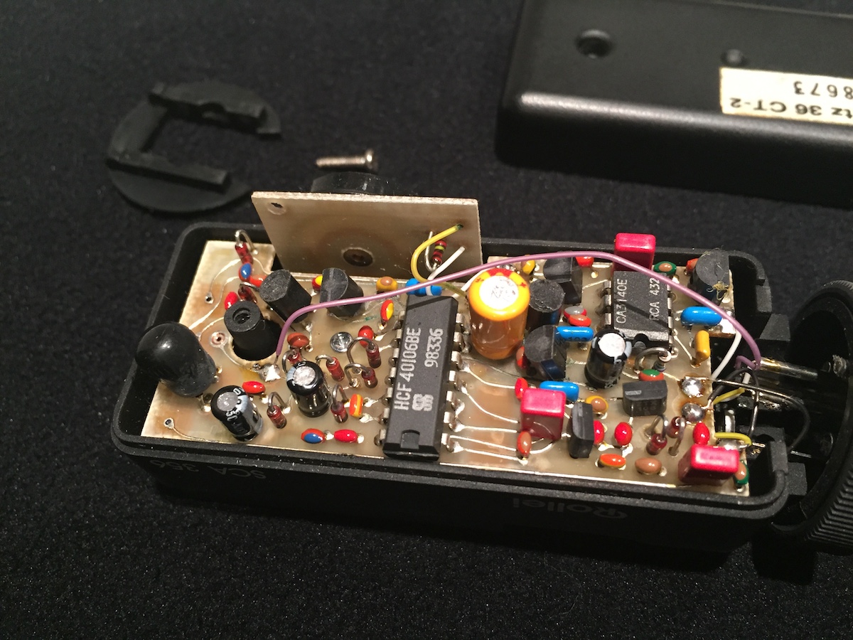

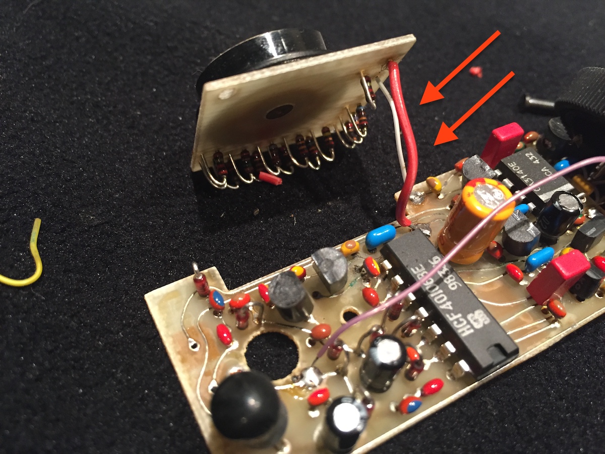

This is what it looks like with the bottom of the case removed.

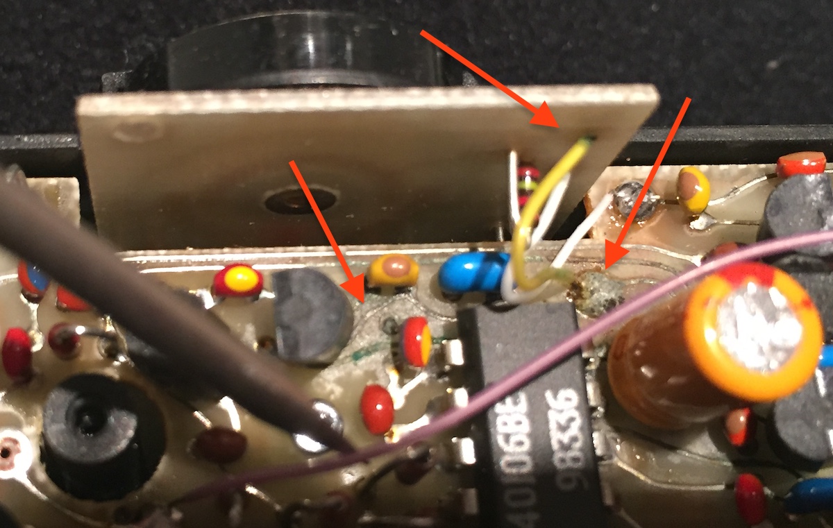

Suspicious areas. Corroded solder joints. Combine these findings with 'intermittent operation' and likely cause is cold solder joints.

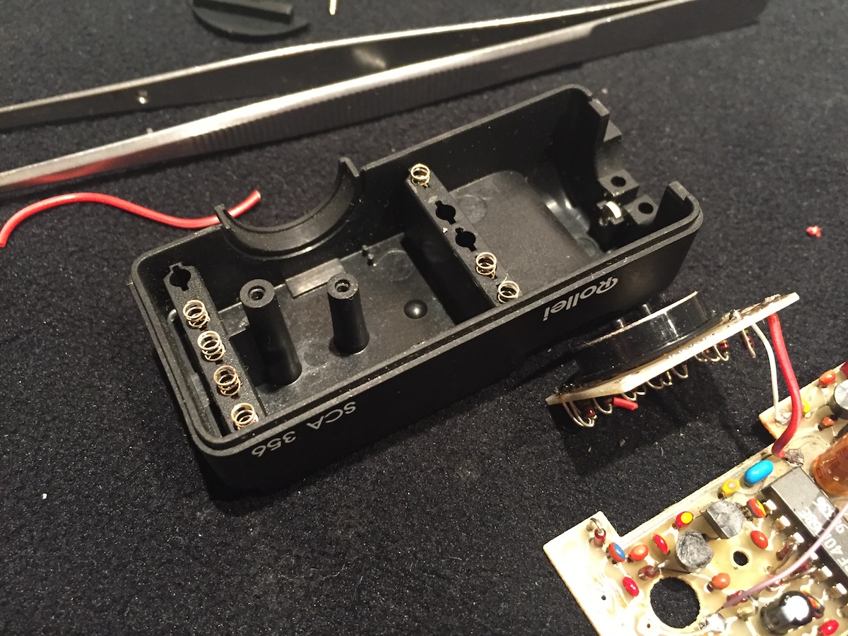

The base, that makes connection with the flash unit. No corrosion or anything that looks like it would cause poor contact here.

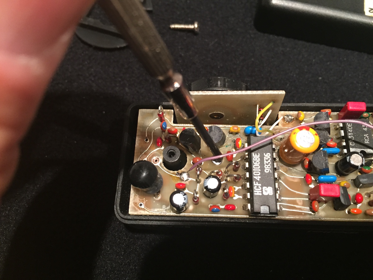

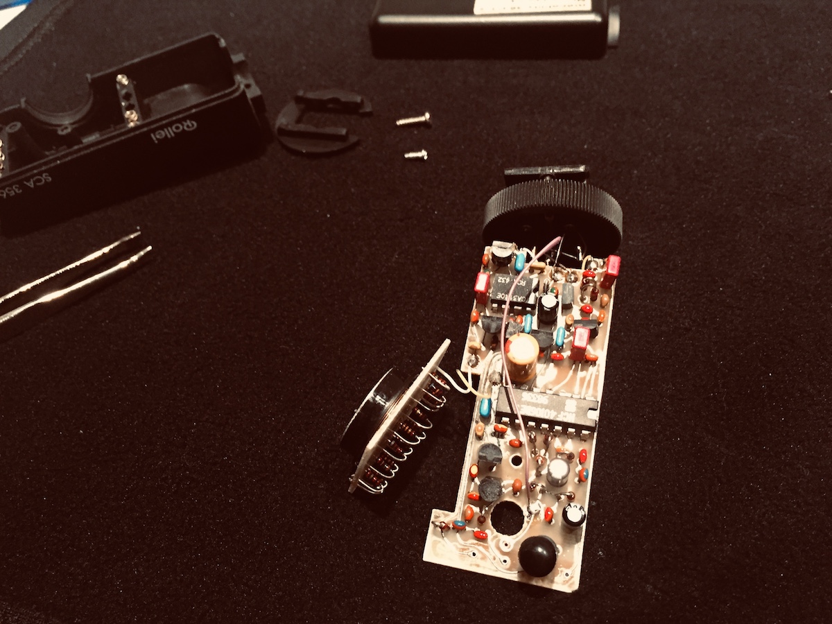

To re-flow the solder joints, the PC board needs to be removed from the top half of the SCA housing. There is a single screw.

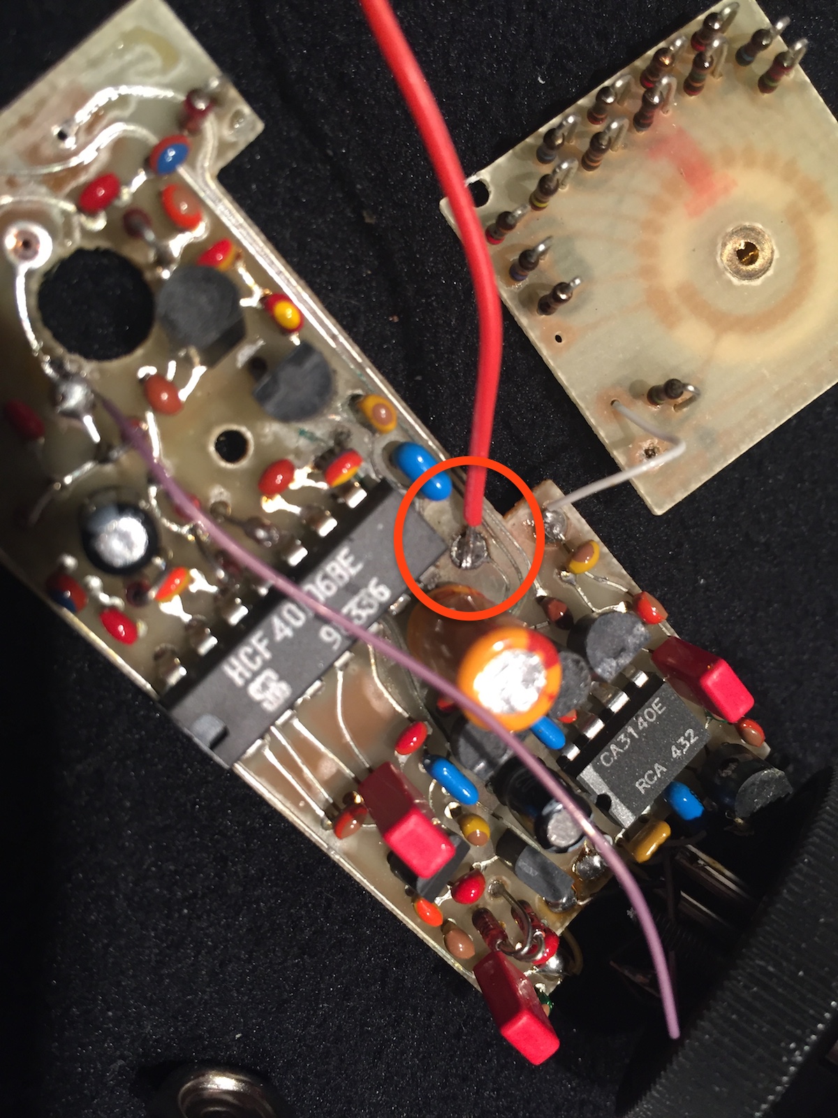

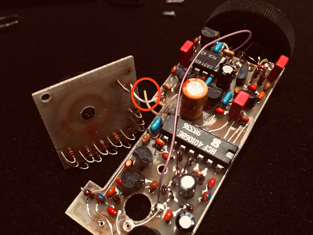

This wire to the ASA resistor bank broke off. It was corroded at both ends. This is was not the problem, but will needed to be corrected to complete the repair.

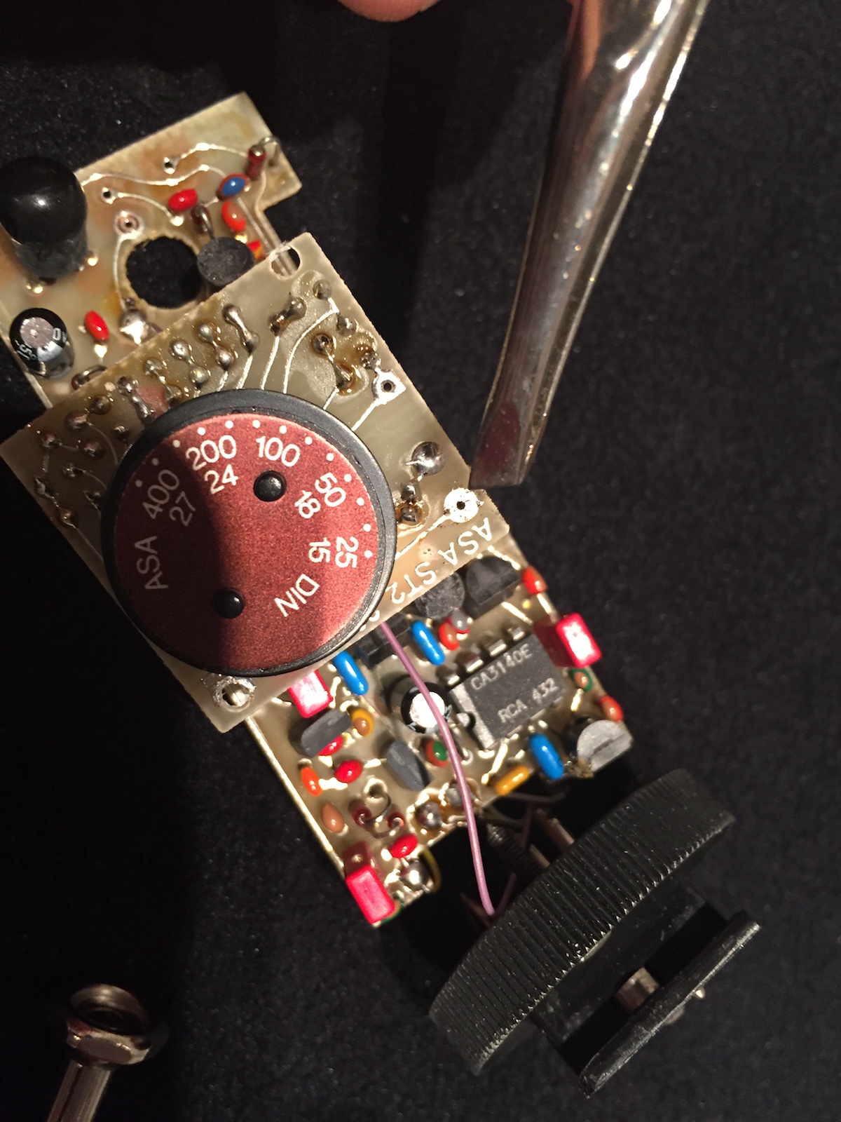

The PC board was turned over and solder joints re-flowed in the suspicious areas. (not shown, can't hold the soldering iron and take pictures at the same time).
Now to replace the wire that broke from the ASA resistor bank. The old wire was removed and the hole opened up with solder wick.
No hole for this end of the wire, just a 'pad' for the connection. This was cleaned and the new wire soldered in place.
New wire to the ASA resistor board in place, soldered at both ends.
Re-flowing the cold solder joints has restored all the added functionality of the unit! Of course this is only two functions, the lightning bolt in the finder and automatic setting of the X-shutter speed.
