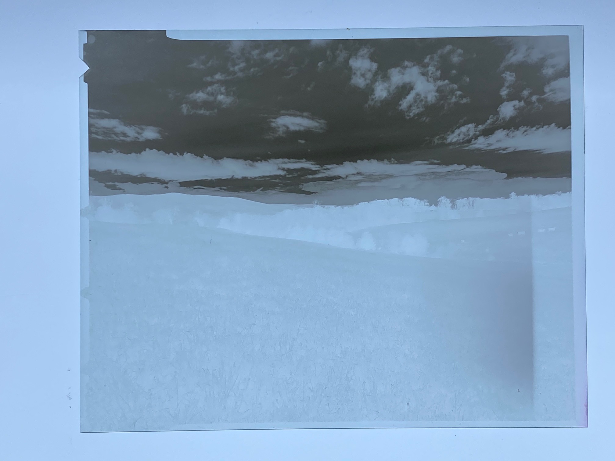

Photo of negative on light table (and yes, I know there's a light leak, this is a problem with that specific holder). This is a sunset, I measured the foreground grass at EV7 and the brightest part of the sky at EV15, I put zone V on EV9.
Looks like you lifted the film holder a bit when you were moving the dark slide. Looks like the biggest problem is underexposure, theres faint detail in the landscape but needs more light.
Agreed. The problem is not underdevelopment but under exposure.

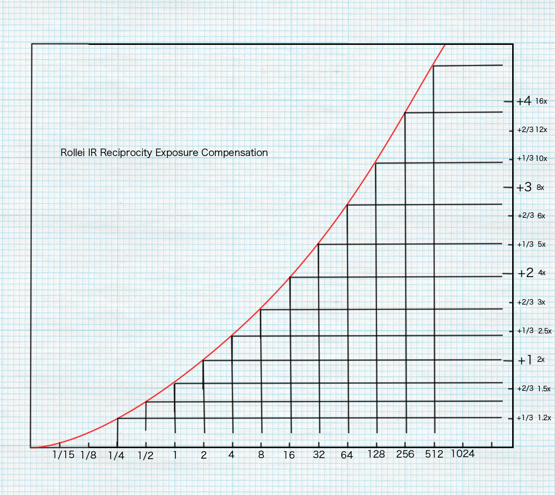

I've also included a reciprocity compensation chart that I generated myself. I've used it for years without issue.

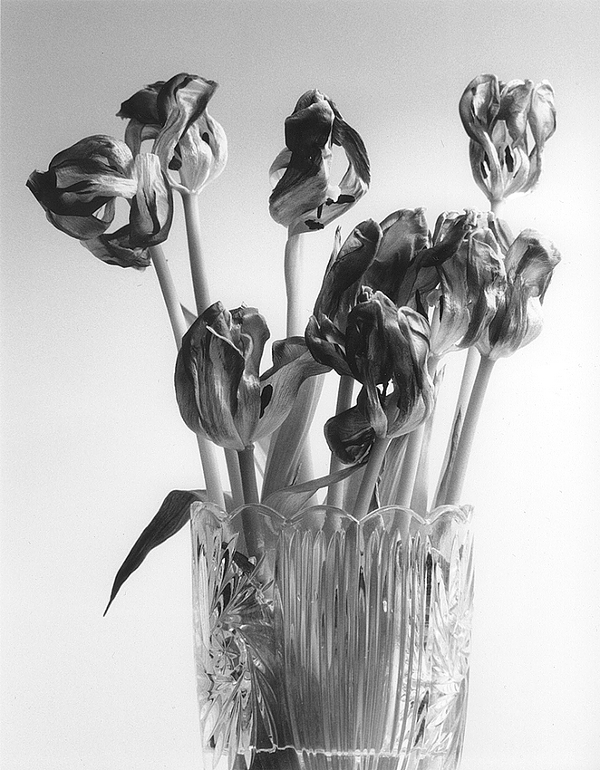

Ilford SFX exposed without a filter.
Ilford/Harman liked it enough to award it a "honourable mention" in the Ilford APUG print competition many years ago.
