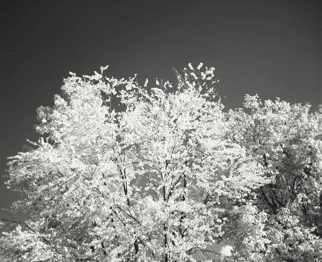

This is what I got with ISO 3 and Rollei IR at the end of August with Heliopan RG 715. First try with this film.
A bad scan I know.
