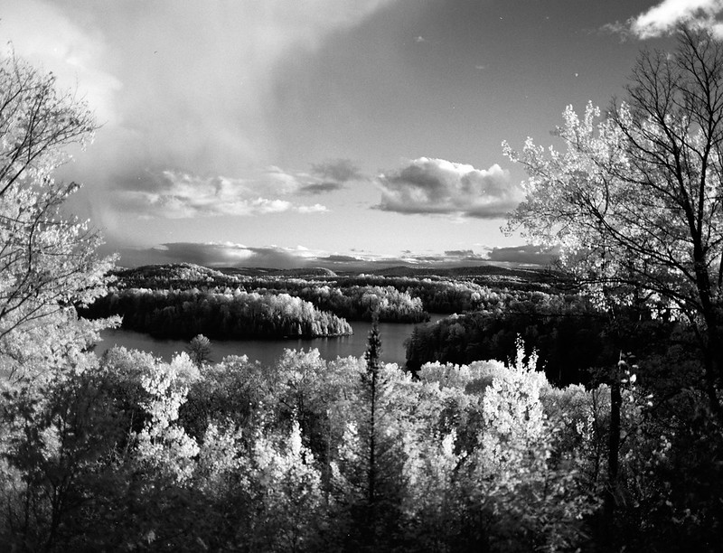

PKM-25: i can't stop admiring your picture. I see that IR really agrees with rocks too - not only foliage and skies. What filter did you use for this shot ?

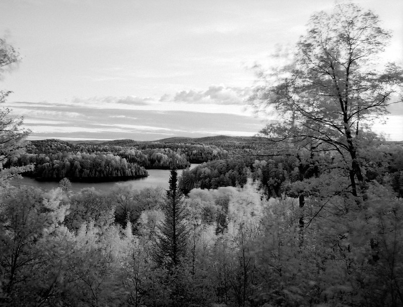

So, second roll developed, again with an R72 filter.  Still a little weak, I think I'll try to push things up by one stop for the next roll.

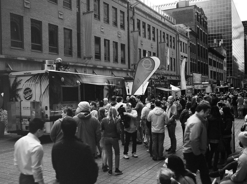

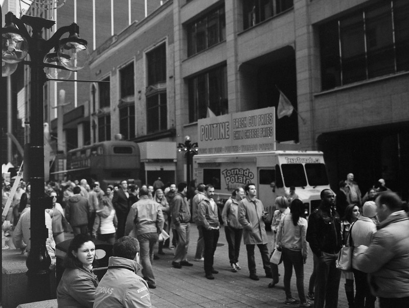

Here are some 645 photos from the 120 roll. I think most of my exposure problems are due to faulty metering guesses on my part.
georg16nik
Aug 3, 2010
1,101
Here are some 645 photos from the 120 roll. I think most of my exposure problems are due to faulty metering guesses on my part...
You don't meter for IR film, since You can't.
The Rollei IR 400 is not ISO 400 film, not even by a long shot.
I would barely give him ISO 200. So, you rate it at ISO 10 or 5.
Your scans shows underexposure by at least 1 stop and it's also likely there wasn't much IR present where you shot it - e.g. low altitude, especially the downtown shots.
Also, R72 is a bit too strong for such weak IR film like Rollei IR 400 (Rollei Retro 80S is actually better suited), meaning that you need real high altitude and/or lots of IR to cut through to the film and have a decent exposure.
