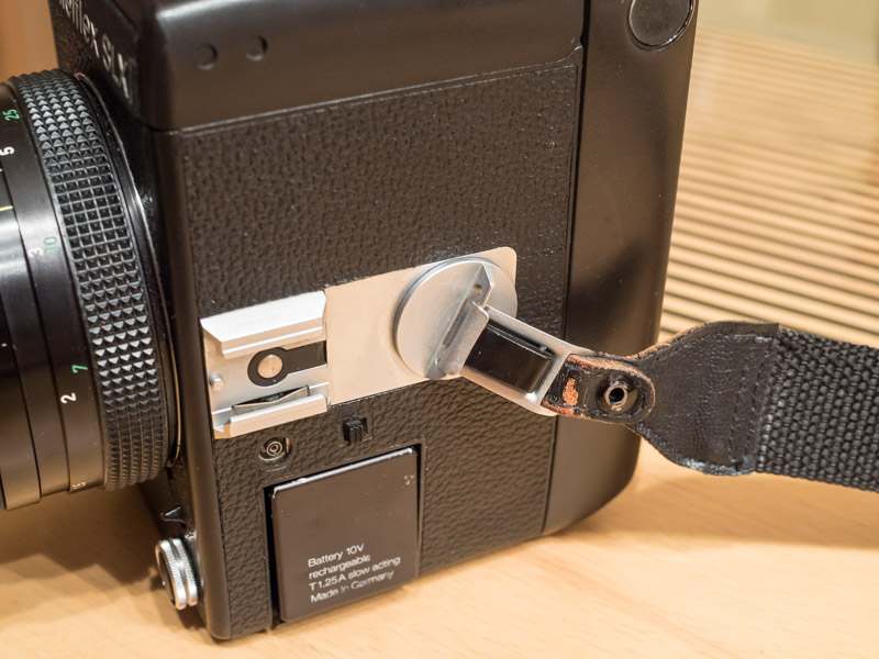

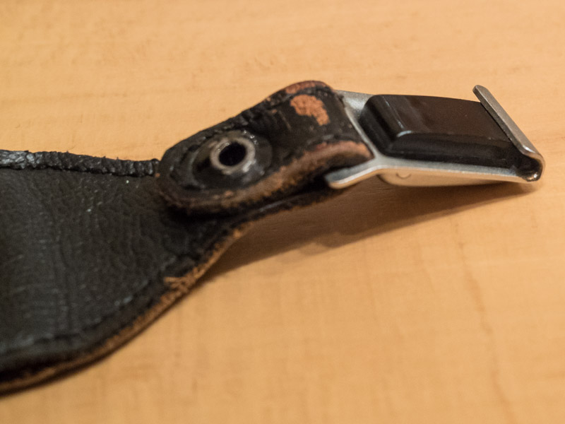

Been a Roller 6008i shooter since was a new product and I must say despite the relatively lamer look and thicker style the original strap has proven to me to work the very best. Clips work perfect and strong; the strap is grippy when needed and when flipped over has a good light slip making it easy to swing off the shoulder quickly. The shape also lets the camera hang well with the lens. I would encourage you to seek the original strap at least to try. I've seen them around theres still new old stock. Enjoy the camera, wonderful handling.
