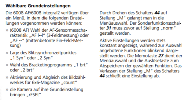

Resets the 'custom function.'
It is on page 60:
(switch 44, position M)
EDIT: this is from the manual of the 6008 Integral2 which is not appropriate!
Well... thanks! Seems one of my problems has to do with the English manual for the 6008 Integral... which stops at page 50. I will cross check the 6008 Integral 2 manual in English to see if something else is listed there. But at least you've given me a start... both AgX and IC-Racer. Thank you! Also glad to hear from Rollei 6000 series shooters out there.
To reset a 6008i to factory settings: Turn knob to 'Reset custom functions' position (green), then push small 'mirror up' button on left side of the camera and let button go. Turn knob back to any other position of your choice. It is on page 20 of the 6008 integral manual. The above reference to page 60 is for the 6008AF/i2 manual. That is not the right one. At this point the 6008i2 is quite different.
Settings can be changed and restored with the Master Control Unit (MCU). The on-camera reset procedure is more like an emergency measure when the MCU is not on hand.
