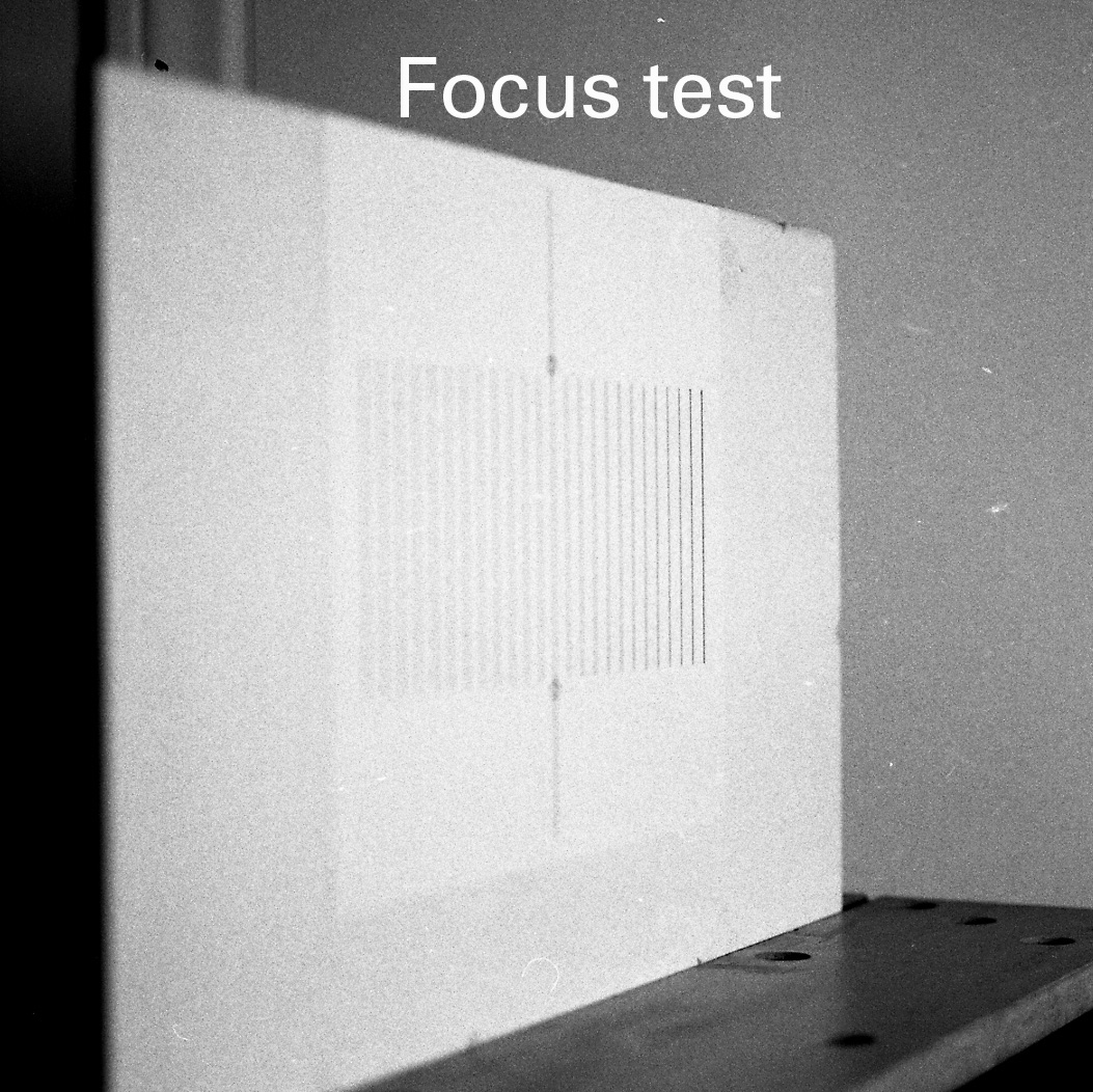

Film image is focused a few inches behind the screen focus when shooting at the closest. Here's a test shot per Barry Thornton's method in "Edge of Darkness." Screen focus was on the center (longest) line.
I cannot find a service/repair manual online for your camera nor can I find good pictures of the mirror box or view screen mounting. If I had the camera in my hands I could determine the cause of the error and a possible fix.
My prime suspects are 1.) the mirror bumpers are deteriorated or compressed allowing the mirror to drop down further than it should by .1 millimeters give or take .05 millimeters or 2.) shims between the view screen and its mount have deteriorated allowing it to drop down a little. You make no mention of a shift in focus from side to side or top to bottom and your focus shift example shows even side to side/top to bottom focus so the back/lens/camera box are in proper alignment.
Is there any play in the view screen? (side to side/up and down)
