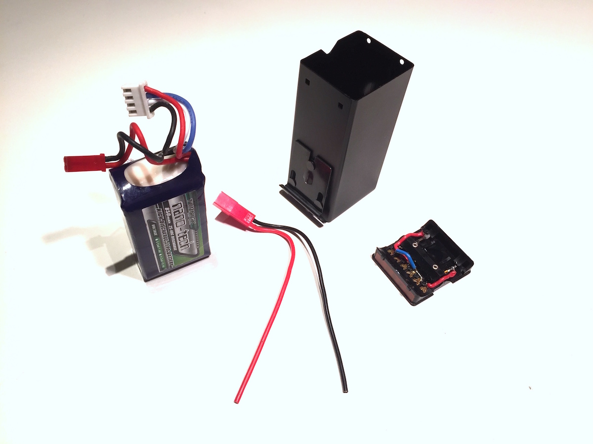

I charged the 3-cell LiPo in my battery case back in early December. I still have not done 800 exposures. The battery still reads FULL CHARGE via the camera. I was out in the cold the other day and it performed well. I anticipate I'll only have to charge it a few time a year.

View attachment 195622 I charged the 3-cell LiPo in my battery case back in early December. I still have not done 800 exposures. The battery still reads FULL CHARGE via the camera. I was out in the cold the other day and it performed well. I anticipate I'll only have to charge it a few time a year.

However I also think that LiPo replacement is a good idea, having all the benefits of NiCAD's high discharge rate and NiMH's longer run time with no memory effect and very slow self discharge. I just have all the equipment to keep NiCAD's at their optimum.
Careful, the guy on eBay does not sell the battery with a proper charger. You get a decent 3d printed battery holder, and 3 nice 14500 batteries and a 12v power supply. I ended up taking out the 14500s and charging them externally, but this may cause wear on the tiny wires. Looking to see how to hook up a hobby charger to the 2.5mm plug
I have seen the 3 cell lipo in post #3 for less than $10.
That gives roughly the same number of exposures as the disposable lithium batteries for my Nikons, at 1/2 the price. I suppose one could just throw it out, rather than recharging it 1000 times, if one so desired.

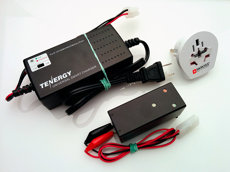

My "cheapo" solution was to change the NiCADs to 1600 NiMHs and purchase a Tenergy charger. It worked perfectly!
Yes that's the charger I got when I changed mine to NiMhs but here it is dead now... hmmm..

film_man: Ditto to feeling your pain. EXACTLY as my SLX2 failed. And the eBay advertised replacement batteries and charger were completely bogus in my experience, too. IC-RACER and I have documented on a separate thread ( https://www.photrio.com/forum/threads/the-power-of-volts-and-milliamps.105128/ ) sources for parts and how to rebuild the batteries with LIPO drone batteries. Since completing that 20 minute project, I have run over 20 rolls through my SLX2 and 6008 using the same battery without a recharge. The result is that I ended up finding the Rollei SLR's such nice cameras I have upgraded to the 6008 Integral. I now have 2 rebuilt batteries and 1 I have yet to rebuild that seems to work with the NiCad/Nimh, but I will rebuild that soon enough. There are some other issues that may arise, but I've simply taken to numbering all the gear (backs, inserts, etc) so that I can debug and winnow out what seems to have reliability problems and what works great. The 6000 series's is a very well engineered camera, and the effort to build reliability into the user's gear should pay off in a real shooter's camera. There's a lot of gear out there as folks seem to lose patience with it... which I can understand, btw. But if you can get through that, then the rewards start making it worthwhile. I just shot 7 rolls this weekend. Lots of fun. Looking forward to developing to see what I've got.

film-man: If you have a Rollei battery case, FWIW if you want a reliable rebuild and feel up to the small effort ic-racer and I documented, Hobby King (which was the source of the parts used) is currently having a sale. See: https://hobbyking.com
