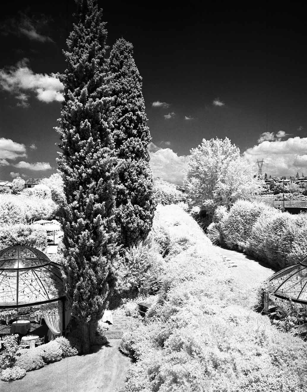

Super late to reply but I created the thread when I was in Italy and loading the roll. The results were incredible!
Thank you all!
I don't have my notes but I think I shot f4 at 1/60 with the hoya IR filter (I'll update when I find my notebook)
Thank you all!
Great photo, hope there're more to come. Just to provide a bit more info, what working method did you employ to arrive at those settings please?

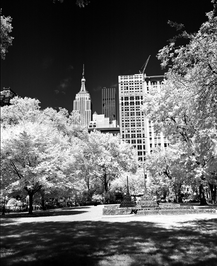

I still haven't located my notebook (after moving apartments) but I just shot another test roll in NY this past weekend.
I didn't meter this time, I just shot the whole roll at f4 1/60 (bright sun, blue sky, sun to my back) and that seems to be a successful setup with the Mamiya 7... (so far). PS: Using the Hoya 72
Wow, that's a beautiful photo, you should be very proud of it. Your settings of f4 and 1/60th seem to work perfectly. 1/60 is 2 stops faster than the 1/15th I used when shooting with SFX200 and the IR72 filter, but how many stops difference is there between your f4 and the f11 I used (I always find the amount of stops between any 2 fstops confusing to work out compared to shutter speeds)? If it's 2 stops, that would mean our reciprocal exposures were virtually identical.
Great shot. Your results are similar to what I use. My standard exposure with Rollei IR400 and a Hoya R72 filter in bright sun is 1/4 - 1/2s at f16, so about ISO 3 with sunny 16.
